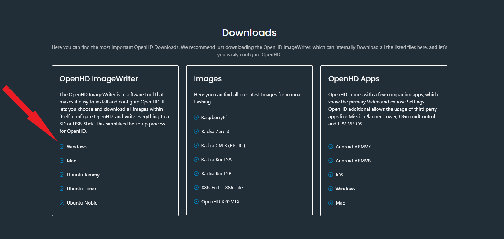

Step 1: Download and install the latest OpenHD ImageWriter, which is based on the Raspberry Pi Imager, from https://openhdfpv.org/#downloads and Backup Mirror.

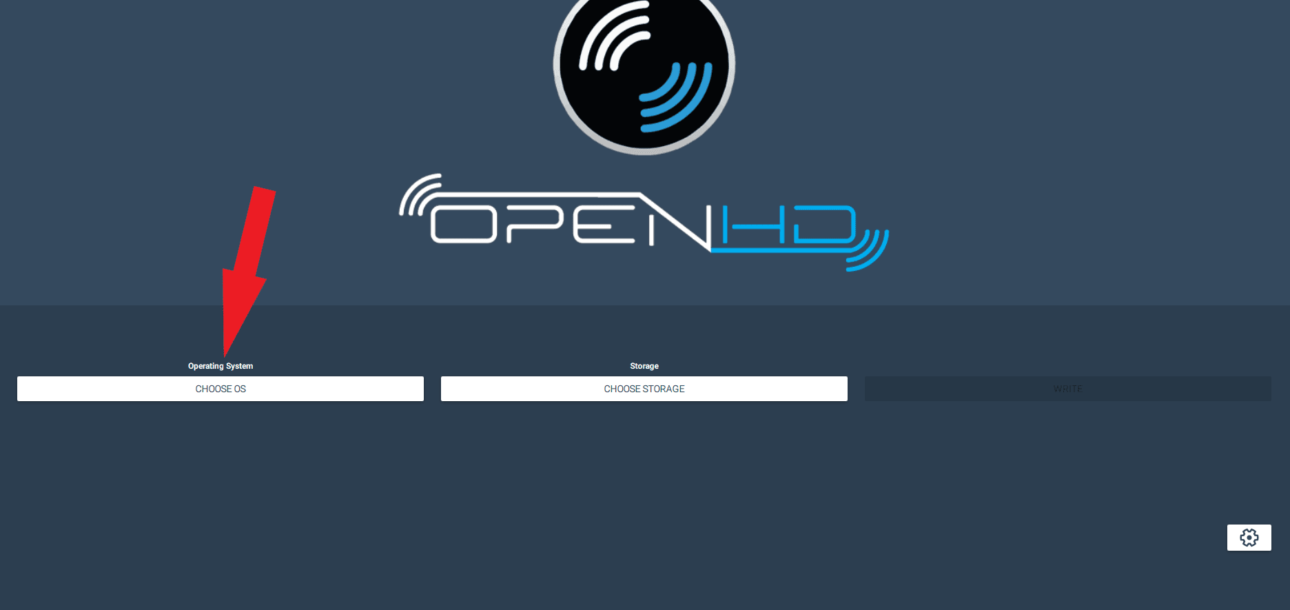

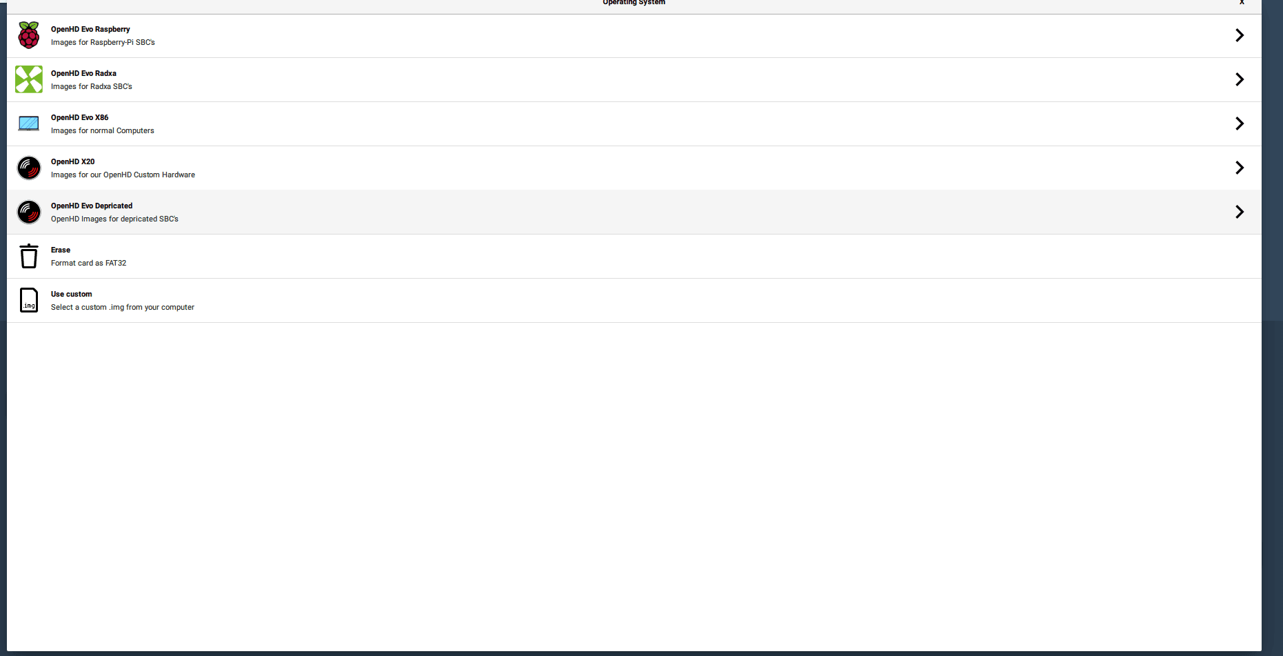

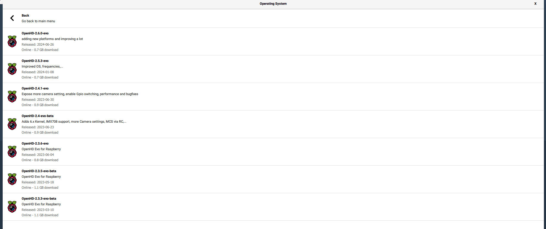

Step 2: Open the image writer and select the latest OpenHD release from the drop-down menu. The image writer will automatically download the selected image. Alternatively, you can manually download the image and flash it using the "Custom image" selector. Ensure you unzip the image externally first and then select the .img file (not the .zip file).

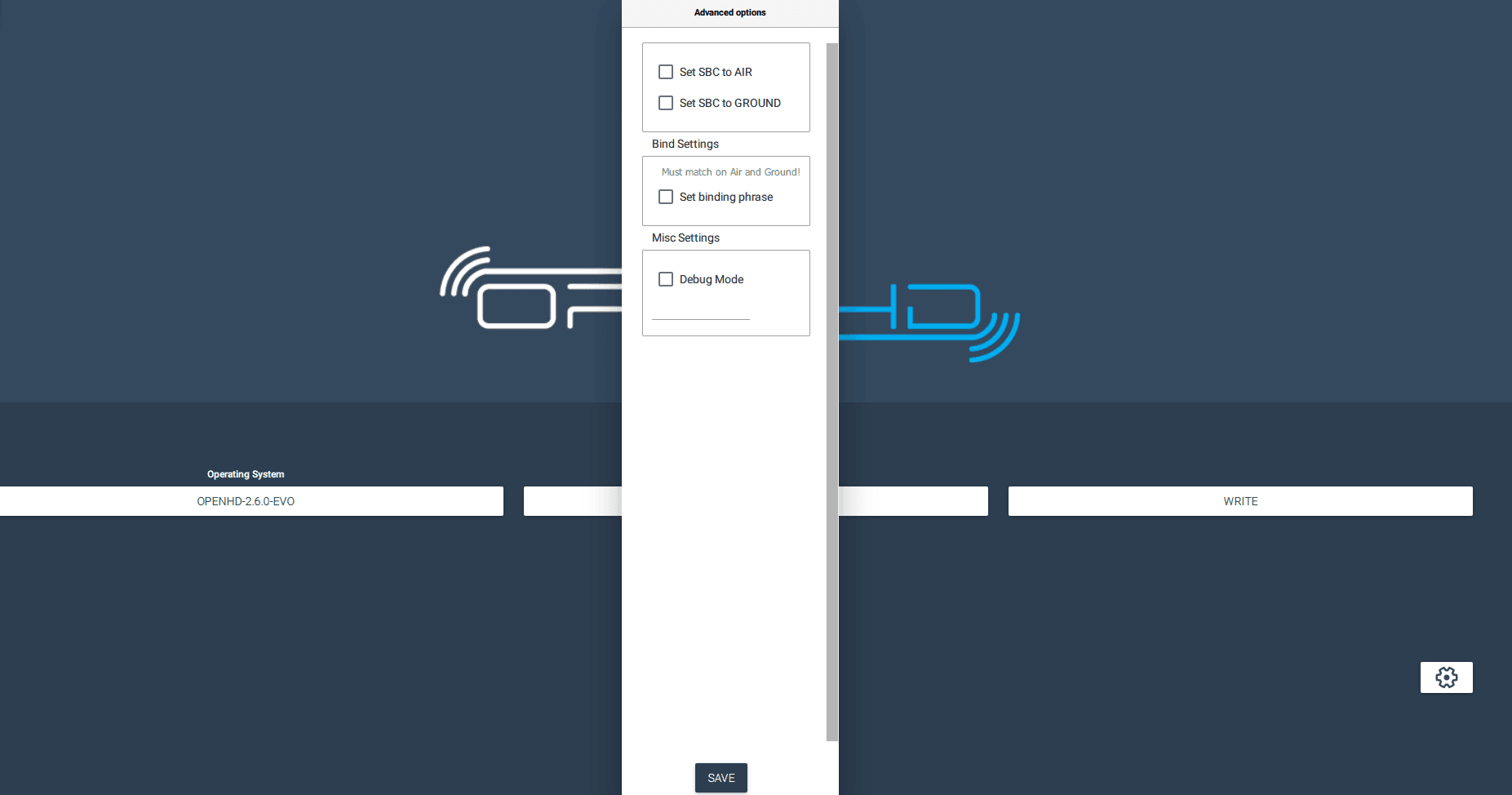

Step 4: Click on "Settings" in the lower-right corner and choose either "Air" or "Ground," depending on whether you want to flash an air or ground image. This step is essential for a functional OpenHD setup; you need to flash one Air unit (select air) and one Ground unit (select ground).
Step 4.1: In this step you can also select a binding phrase to improve the protection of the link (its not mandatory) both binding phrases on air and ground need to be the same (you CANT change it after without a reflash of both air and ground sds), if you want to use it just click on "set binding phrase" and write the phrase (max 10 characters)
Step 4.2 & 4.3: Air and Ground Configuration
Configure your device type:
Ground Settings
For ground the settings are quite simple, just click on ground and then "SAVE"
Air Settings
For air you need to select "air" and then the camera you want to use (you can change it after that on the settings) also you need to click "SAVE" when you have finished

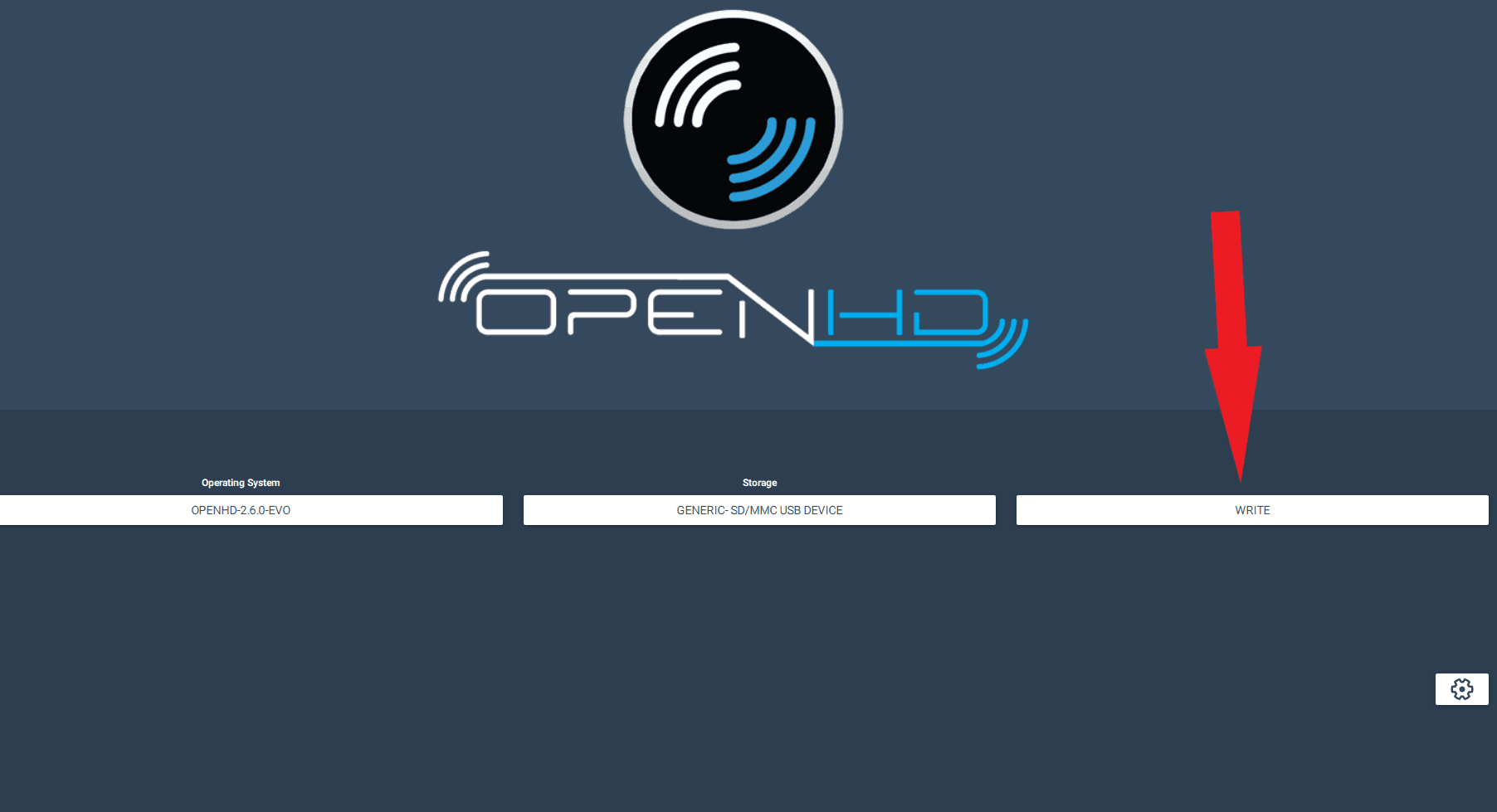

Step 5: Flash your image by clicking on "Write." This process may take some time.
