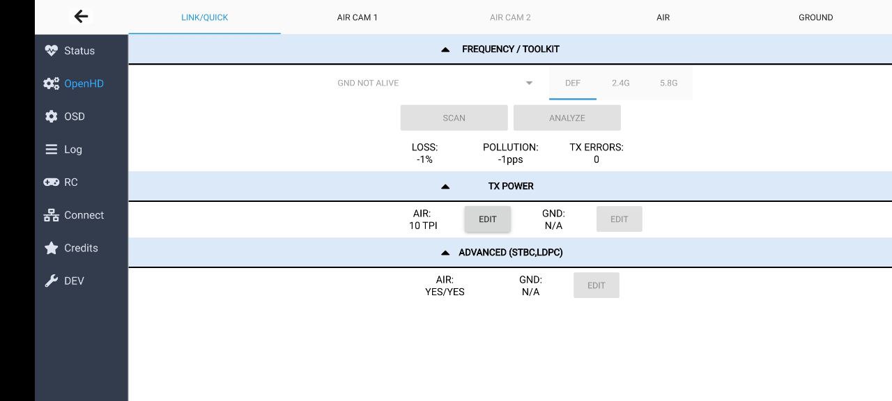

  1. Click on "OpenHD" and then "LINK/QUICK", depending on if you want to edit air or ground click on "edit" on either of the two.
TX power

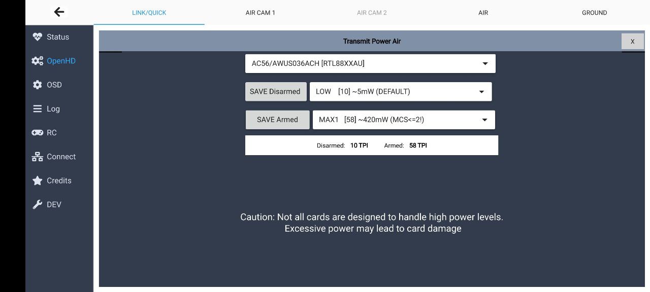

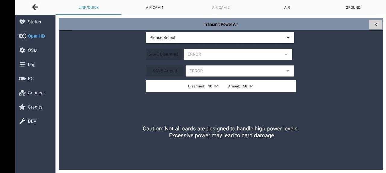

  1. Once the menu is open select your wifi card on the dropdown menu ("Please Select") and then select the power when arm and disarm (dont forget to click "save") When all updated you can also see the power saved in the box below
TX power menu Example of settings
