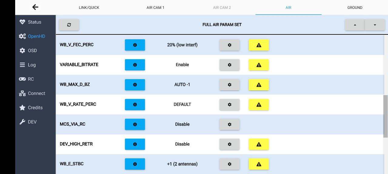

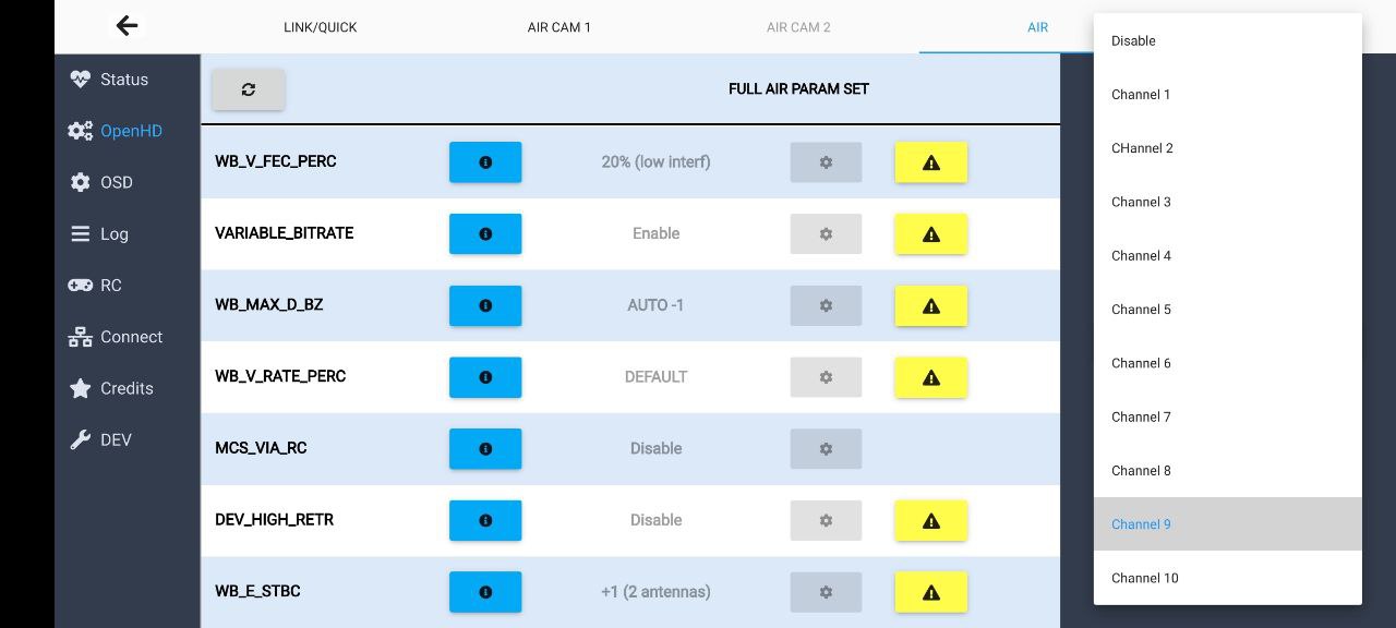

  2. Verify that your RC channels are forwarded from the Flight Controller (FC) to the OpenHD Air unit. You can check this by going to QOpenHD, navigating to RC -> FC CHANNELS DEBUG, and confirming that moving channel 9 corresponds to channel 9 movements.
  3. In the OpenHD interface on your Air unit, go to OpenHD -> AIR and change the setting MCS_VIA_RC from "DISABLED" to your selected channel (in this case, Channel 9).
MCS settings Channel selected Setting done
