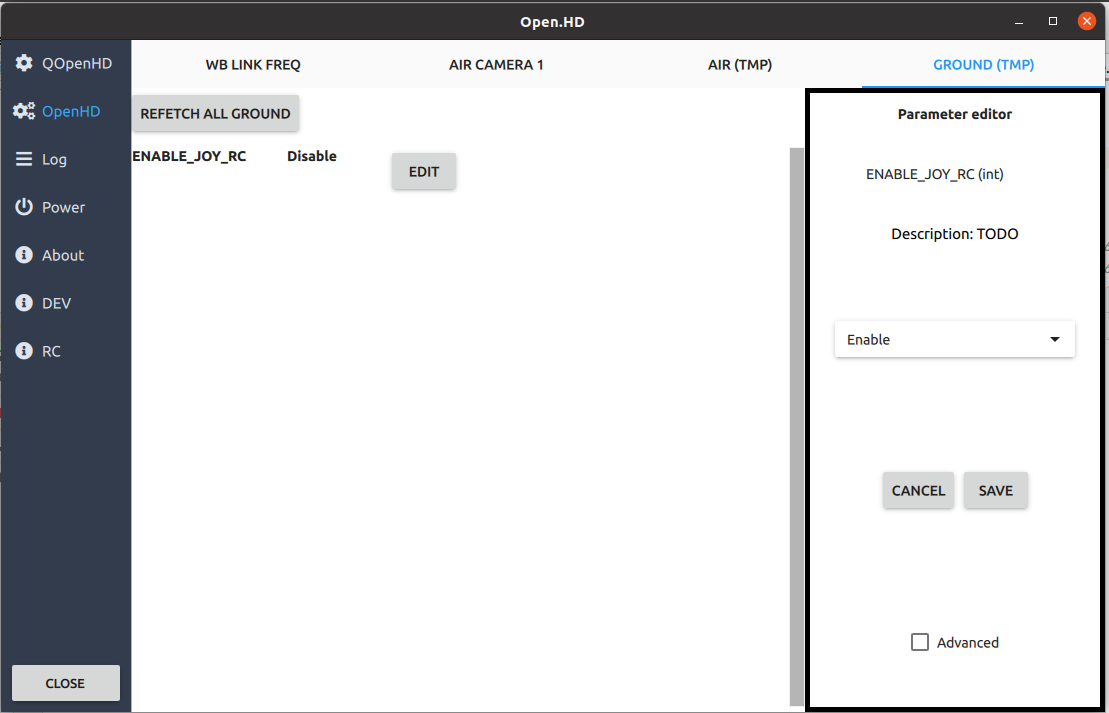

  1. In QOpenHD, navigate to the OpenHD settings page, specifically the GROUND (TMP) section.
  2. Set ENABLE_JOY_RC to true.
  3. Reboot your ground station.
Enable Joystick RC

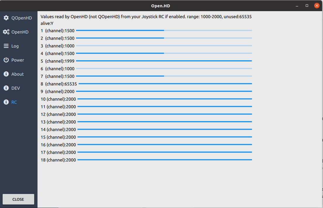

Step 3: Verify Joystick Input​
Confirm that OpenHD detects and properly reads values from your joystick. In the QOpenHD interface, navigate to the RC section to view the current readouts. For example, if you're using a TX16s controller connected with AETR and 18 channels, you should see the input values.
Joystick Input Readouts
