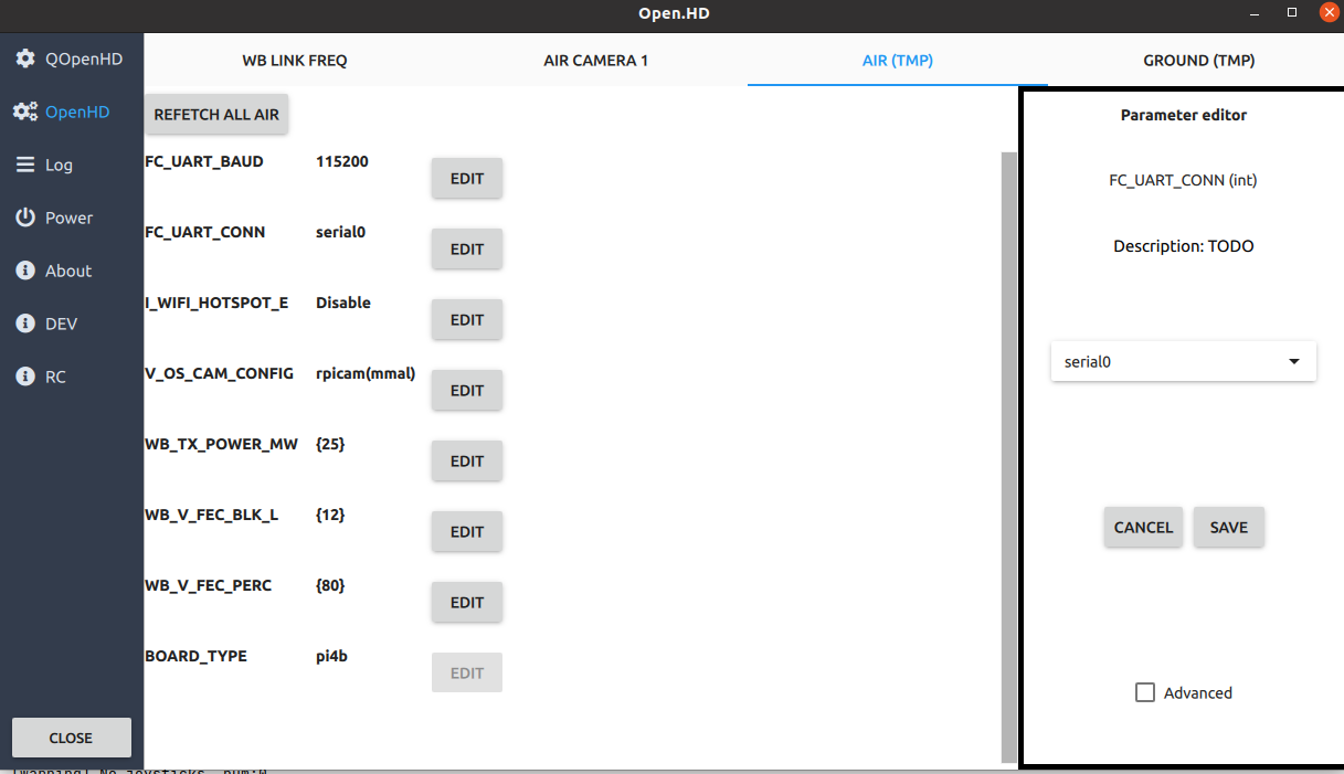

By default, UART telemetry is disabled in OpenHD <2.5 . To enable it, navigate to the AIR(TMP) Settings registry using QOpenHD and select serial0. Be sure to set the correct baud rate that matches your flight controller. If you use 2.5 or higher versions telemetry is enabled from the start on Serial0.

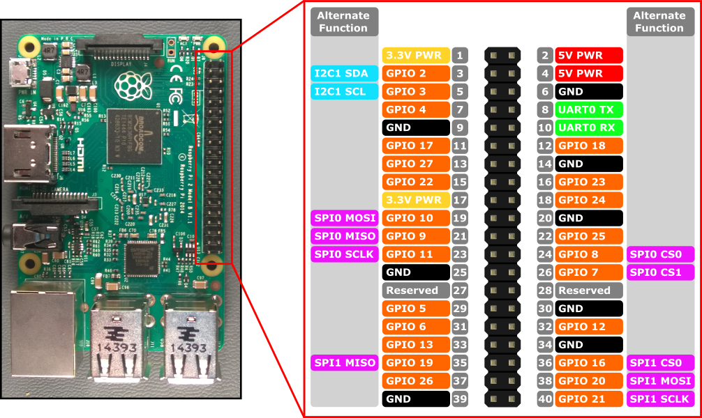

Connect the TX pin of the serial port on your flight controller to the RX pin on the Raspberry Pi. Important: The Raspberry Pi uses 3.3V logic level on its serial ports, so ensure that your flight controller also operates at 3.3V. Connecting a 5V logic level may damage the Raspberry Pi's serial port. Refer to the Pinout diagram for pinout details. RPI Pinout

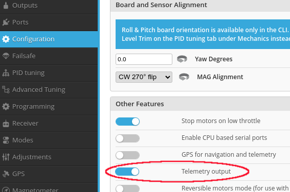

  1. In the Configuration tab of INAV Configurator, turn telemetry on. Click Save & Reboot. enabling telemetry in the configuration tab

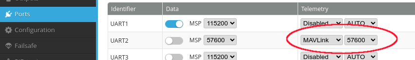

  2. In the Ports tab of INAV Configurator, select MAVLink telemetry and set the baud rate for the port you used on the flight controller. configuring the telemetry port in the telemetry tab
