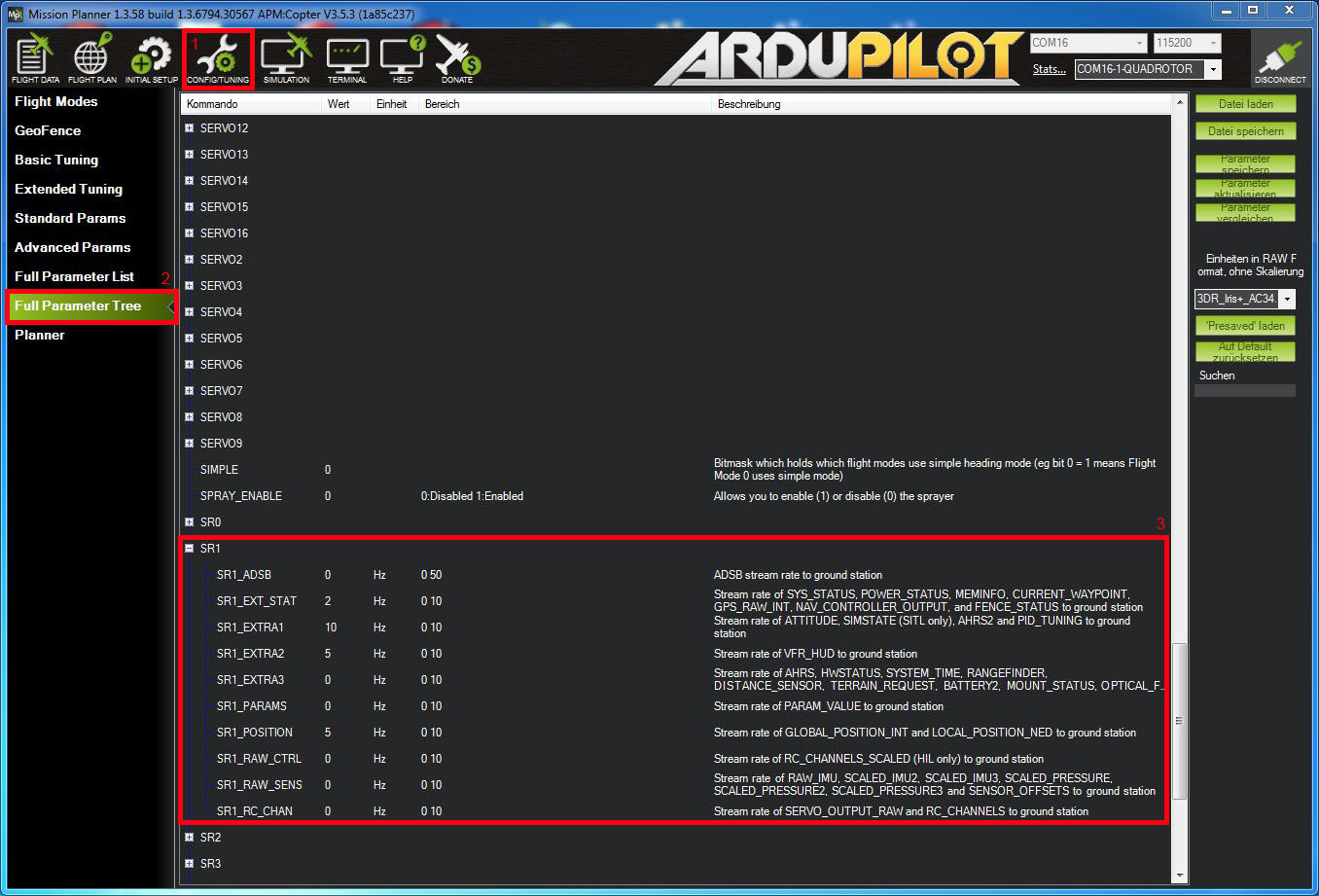

Ardupilot does not send telemetry without specifying the telemetry rates set by the user. In versions below 2.5, this needs to be manually set via the SRX parameters. In versions 2.5 and above, OpenHD handles this automatically.
You can choose different subsets of telemetry information and determine how often you want the Flight Controller (FC) to stream specific sets of data per second (defined in Hz). These parameters are known as SRx_Parameters, where x represents the serial ports using Mavlink in ascending order (e.g., SERIAL0, SERIAL2, SERIAL6 correspond to SR0_, SR1_, and SR6_).
To prevent transmitting telemetry data too frequently over the radio link, select necessary data subsets and find a balance between data update frequency and radio link usage. The following parameters are crucial:

Using the Config/Tuning -> Full Parameter Tree menu, modify the mentioned settings:
Where to find the stream rate settings
Save the settings and disconnect the Flight Controller.
