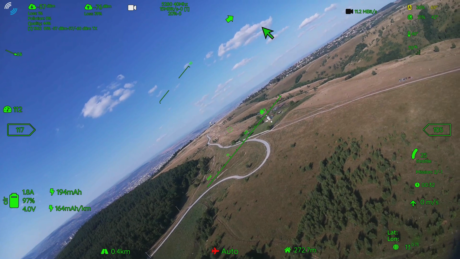

Arducam Skymaster HDR
All of these signals can be sent over a single transmission channel and telemetry is using MAVlink to ensure high compatibility and stability.

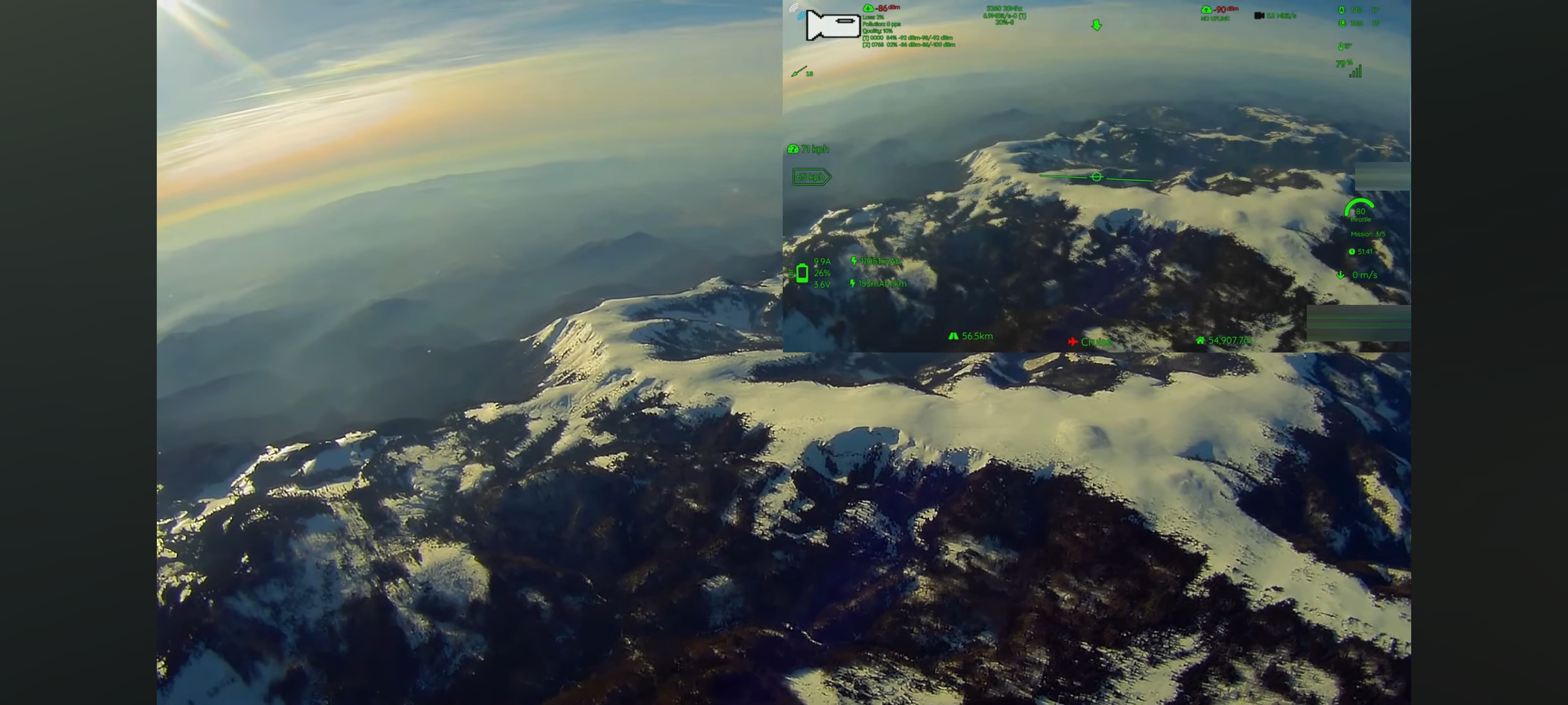

OpenHD digital fpv world record 55km​
55KM_Record
Leaderboard
OpenHD employs readily available Wi-Fi adapters, although not in the standard manner commonly associated with everyday Wi-Fi usage. To ensure low-latency and long-distance transmissions, we configure these adapters to function akin to analog video transmission hardware. This innovative protocol, inspired by befinitiv, has been reimplemented by OpenHD for optimized performance.
The configuration empowers OpenHD to transmit high-quality video and other signals across significant distances while maintaining minimal latency.
