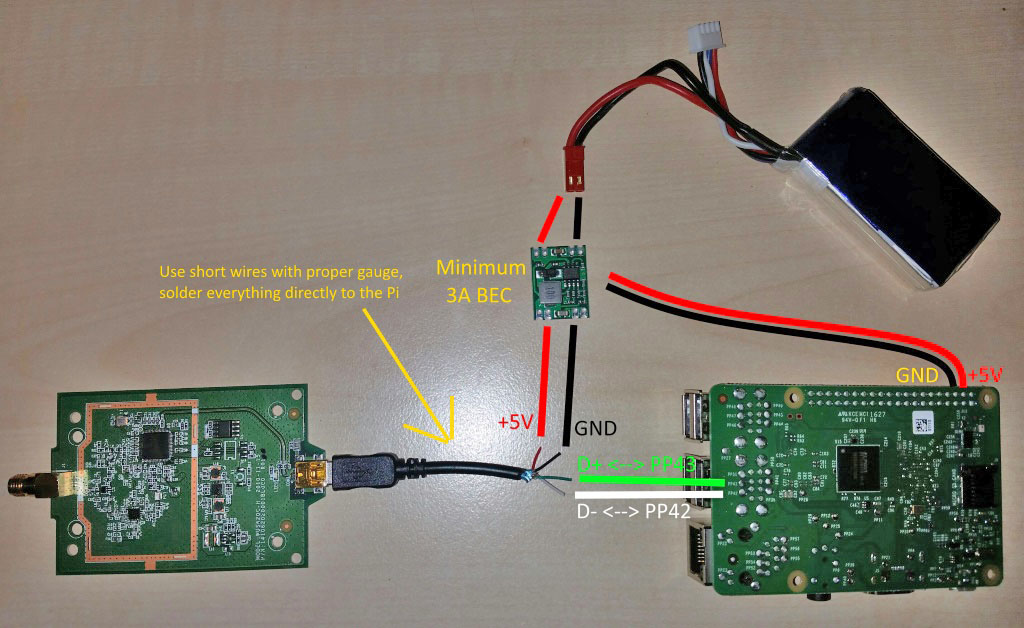

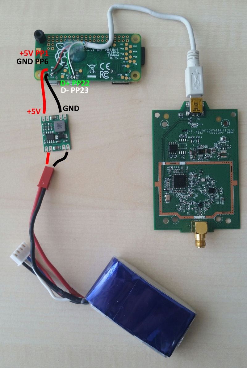

The solution for those kinds of problems is to solder power from a BEC or other 5v power supply, to the wifi adapter(s).

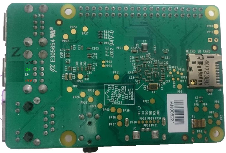

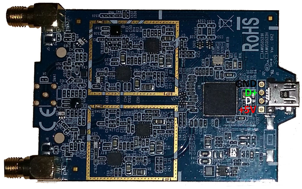

It is also strongly recommended that you solder the USB data lines. On some wifi adapters this is easy because they have ready to use solder pads, or have a mini-USB connector on the adapter (in which case you don't have to solder anything to the adapter itself, just the other end of the cable).

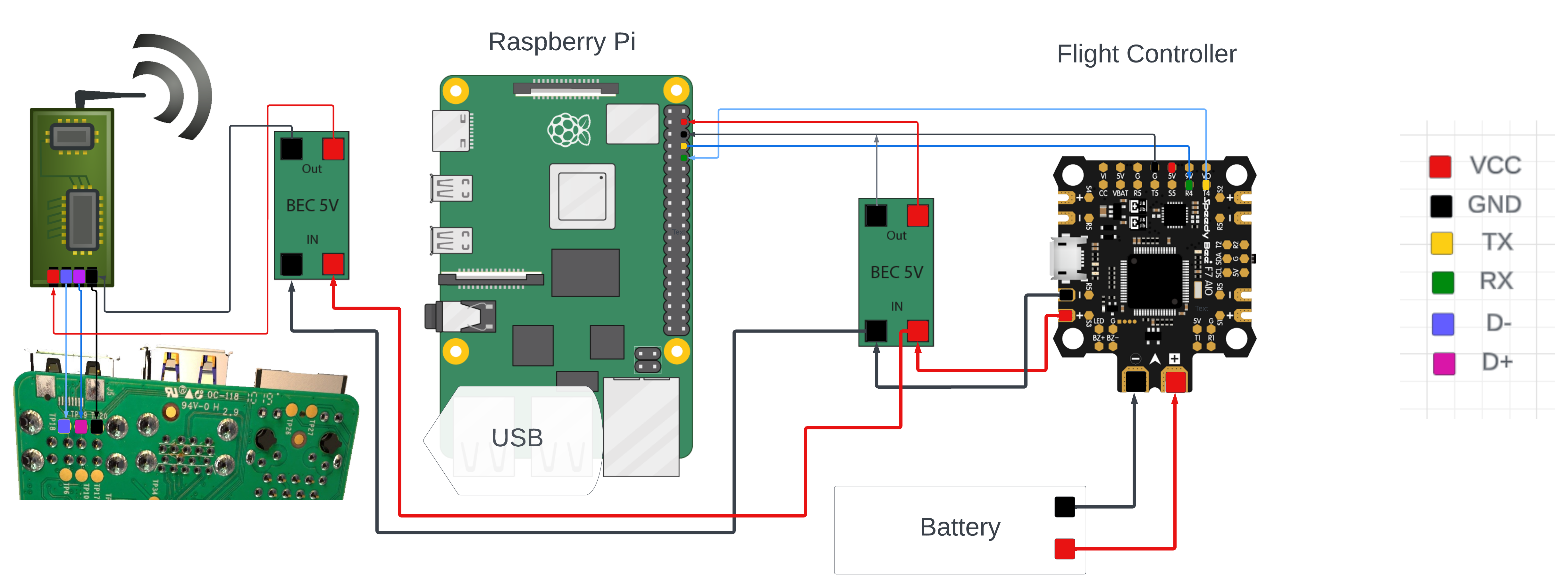

Connection Diagram

  • use short wires
  • use wires with at least 20AWG gauge (0.5mm²)
  • solder everything, avoid any USB cables or plugs
    • An exception is the 036NHA wifi adapter, you should solder the end of the cable that goes to the Pi but the adapter side can be plugged in normally
  • use a quality BEC with at least 3A
  • consider adding low-ESR electrolytic caps near the wifi adapters and the raspberry pi
  • do not use USB power banks
  • do not use the micro USB connection on the raspberry pi for power
  • do power the raspberry pi through the GPIO pins or by soldering power to the underside of the board

Example of a raspberry pi powered through the GPIO pins (+ 5V -> pin 4 / ground -> pin 6) :

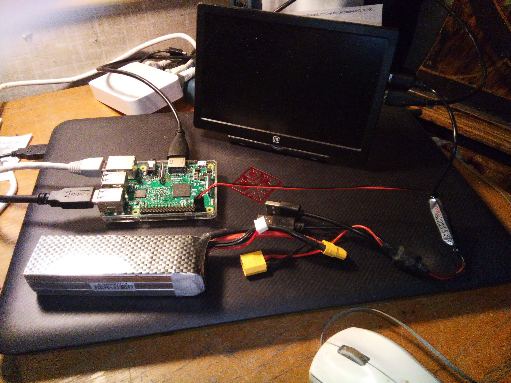

The 3A BEC can also power a 7" HDMI screen with a micro USB connector.
