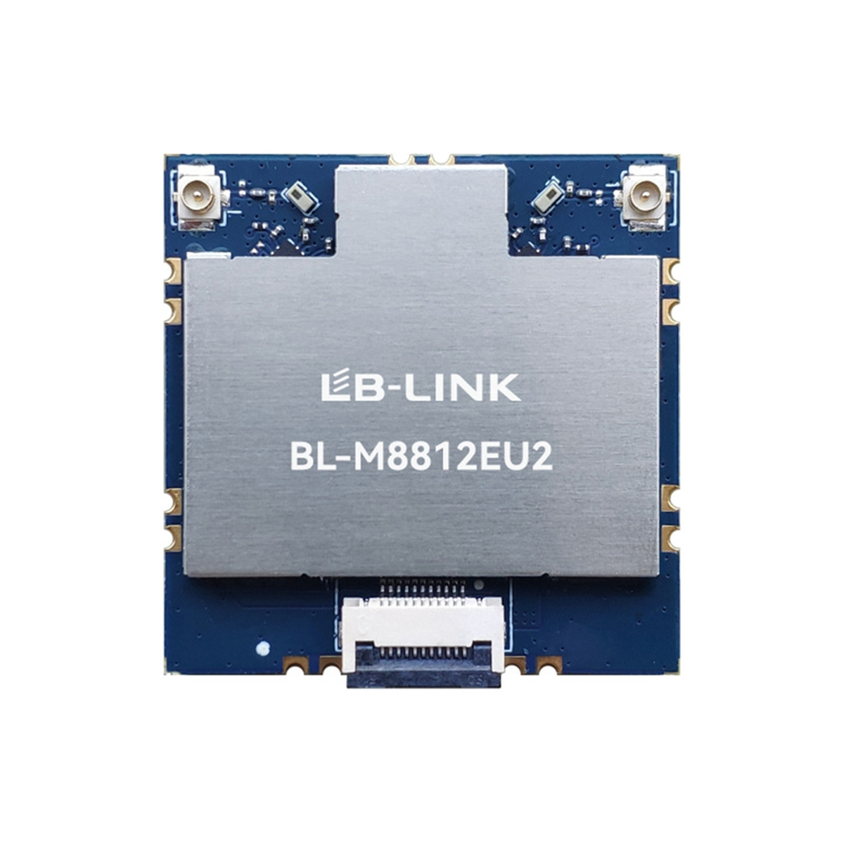

BLM8812EU​
This chip is the most recent wifi chip available and one of the most potent ones, it has one of the best cost/performance relations.
:::warning Important Note This wifi chip/module doesnt have FCC and CE certification to use or buy in EU so if you do that its within your own responsability. :::

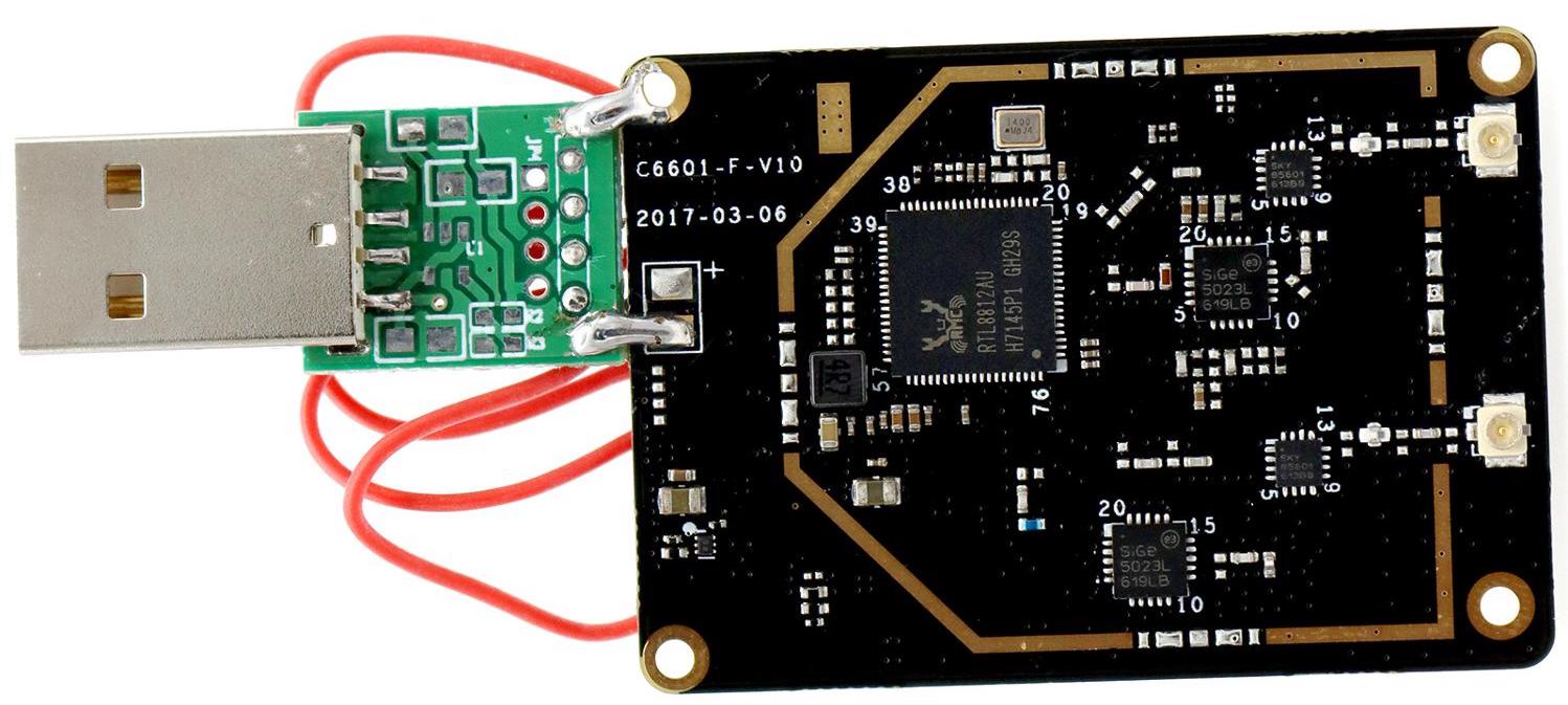

Taobao Card​
Taobao Card
Store link
The Taobao Card is a generic RTL8812AU card sold on Taobao, from which it gets its name. It is widely used and known to work well, but it tends to get hot. The reported power output is 500mW. This card requires soldered wiring, or the USB connection may disconnect before or even during flight. It supports 2x u.fl antenna connectors.
