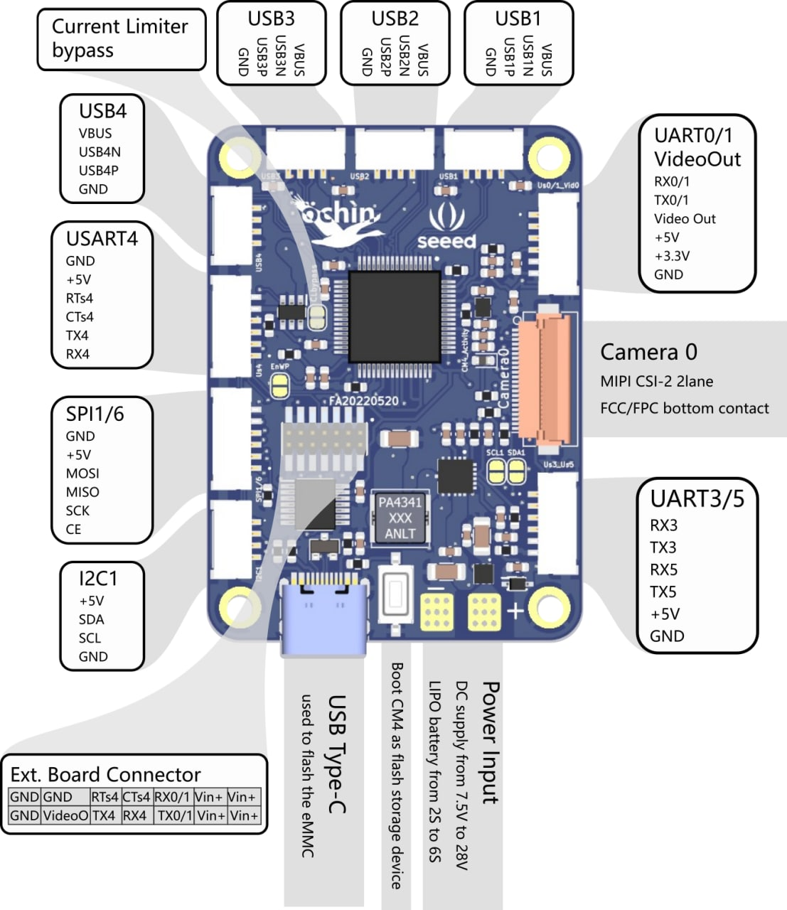

• 4x USB 2.0 480Mbps (4x SM04B-GHS-TB(LF)(SN) connectors)
• 1x USB Type-C (for flashing eMMC)
• 2x CSI camera (2x FH12-22S-0.5SH (55) connectors)
• I2C1 (SM04B-GHS-TB(LF)(SN) connector)
• SPI1 / 6 (SM06B-GHS-TB(LF)(SN) connector)
• UART0 / 1 + Video Out (SM06B-GHS-TB(LF)(SN) connector)
• UART3 / UART5 (SM06B-GHS-TB(LF)(SN) connector)
• USART4 (SM06B-GHS-TB(LF)(SN) connector)
Wiring​
wiring

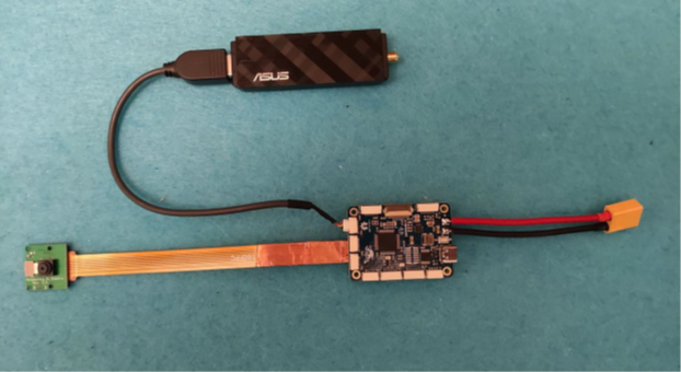

  5. The CSI flat cable is very close to the USBs and it prone to RF noise. It's suggested to shield the flat cable with copper tape (or at least alu tape);
  6. The USB WiFi dongle will drawn some Amps, please use supply cables of adequate size between the ochin_CM4 board and the USB dongle.

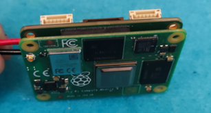

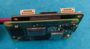

CM4 module installation​
The CM4 connectors are quite delicate and very dense, so you need to be careful.
Before positioning the CM4 module, it is advisable to check that there are no specks of dust or other things that could prevent contact of the pins, if necessary clean with a brush and air.
Place the module gently on the connectors until you feel they are seated in each other (there is a first zero force step where they snap into). When you are sure that the two boards are perfectly aligned and the connectors engaged, press the two long edges of the CM4 module until the connectors are fully inserted.
It is advisable to limit the disassembly of the CM4 module as much as possible to avoid damaging the connector contacts.

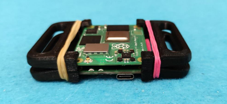

Correct CM4 Module Installation
✅ Correct Installation
Incorrect CM4 Module Installation
❌ Wrong Installation

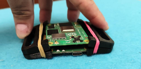

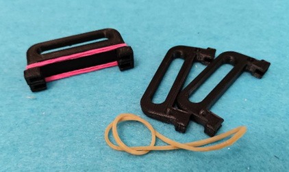

To remove the CM4 module from the ochin board is always suggested to use the proper extractor.
You can find the .STL files to print here.
CM4 Extractor Tool Step 1
CM4 Extractor Tool Step 2
CM4 Extractor Tool Step 3

  1. Power up the board with boot configuration as "mass storage device". • To do so you need to power off the board (no Vin connected) • Press the "nRPiboot" button and, keeping it pressed power up the board using the "Vin" Connector. • Connect the board to your PC using the USB Type-C port
boot

Connecting the WiFi dongle:​
The WiFi dongle can be connected to one of the 4 USB connectors on the board.
In order to minimize the problems associated with connecting a "fast bus" such as USB, it is advisable to cut a USB extender and solder it to a GHS connector, leaving the wires on the connector side as short as possible.
boot

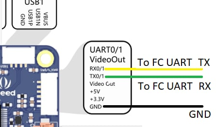

Connecting the Telemetry​
To connect the telemetry to the FC it is possible to use one of the available UART ports, the UART used by default is UART0 / 1.
It is important to keep in mind that the GPIOs of the CM4 module are not 5V tolerant, it is therefore important to be sure that the logic levels of the FC UART are 0V-3V3.
boot
