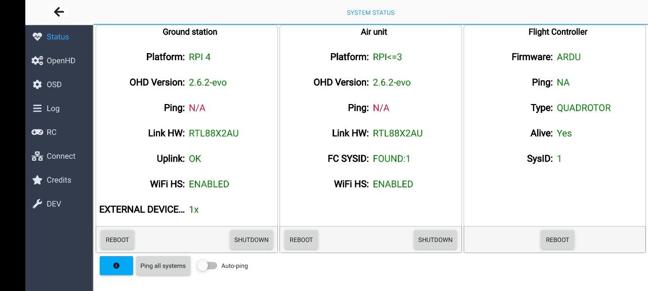

Problem 1: Not having image but you have connection​
To know if you at least have connection you can go to the tab "status" and if you can see both air and ground "live" both are connected and we can move on
Status

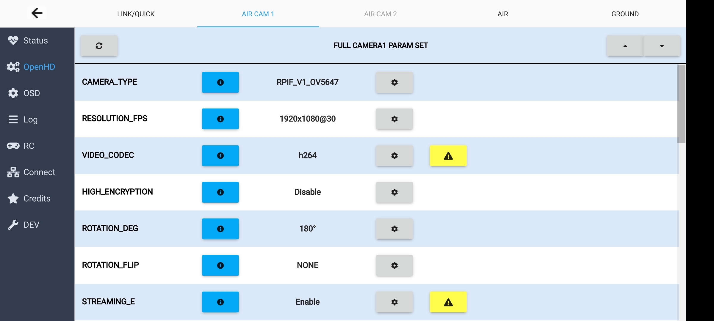

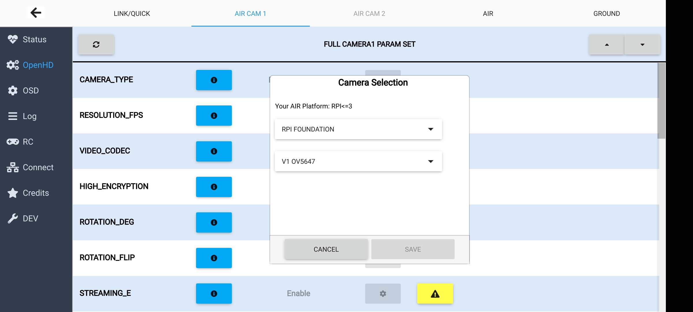

If you haven't configured your camera correctly you'll see a black image that says "rebooting camera", in this case look into the "AIR CAM 1" Menu in QOpenHD (the OpenHD Logo opens the Menu) and select the correct camera overlay in the CAMERA_TYPE setting. After this your SBC will reboot and start transmitting video.
Camera selection Camera selection

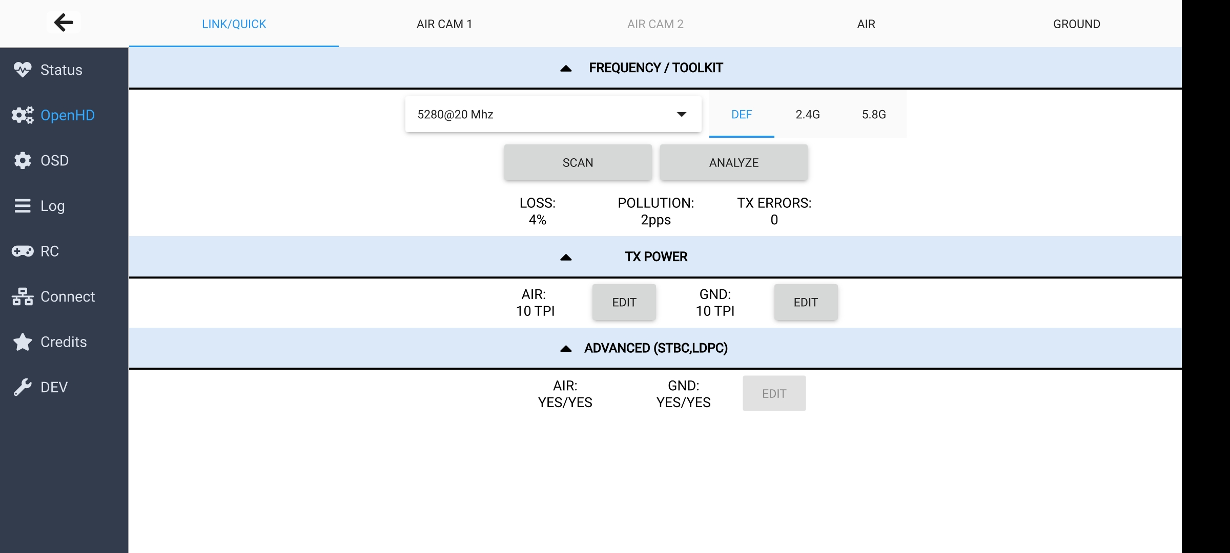

The first thing that almost everyone needs to set up its the power of the cards, the frecuency and STBC and LDPC, you can do all of it in a single tab located in "OPENHD" and "LINK/QUICK" Also you have the options "SCAN" and "ANALYZE" the first one its very handy to find the frequency where your UAV is transmittings and the second one analyze all the wifi spectrum to find how pulluted are the wifi frequencies (it takes a while)
LINK/QUICK
To change the power please refer to the (TX POWER) STBC and LDPC are two important parameters that needs to be turn on on both air and ground to improve wifi coverage and range by using the two antennas to receive and send at the same time, by default both are off because you CANT turn them on in rtl8811au because it only has one antenna

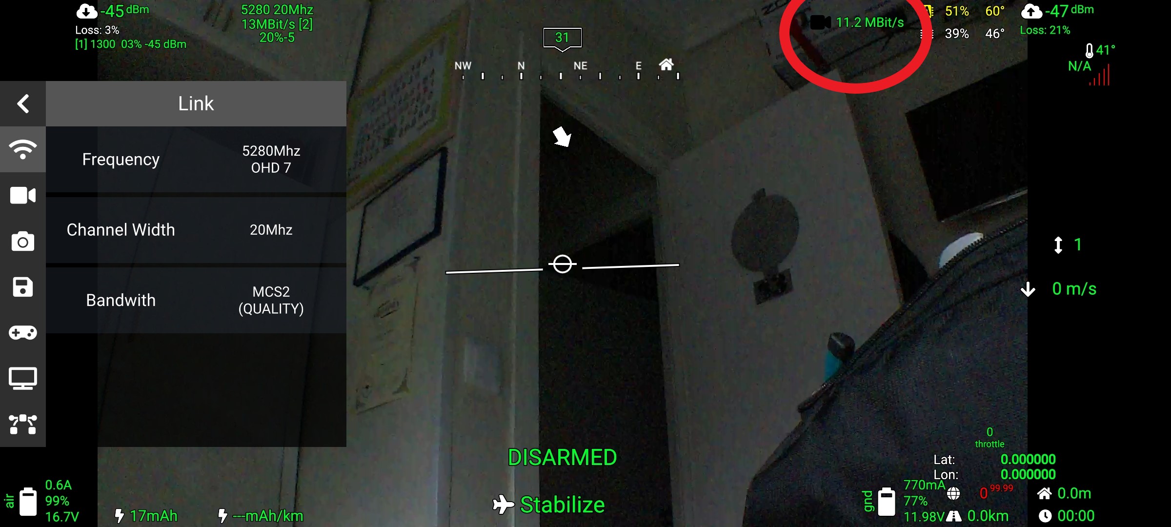

In this sidebar you can finish your configuration and also change settings while flying, you can move around it with the touch or with a mouse In this firts tab called "LINK" you can select your wifi frequency (you cant change it while armed), channel width and bandwith
LINK

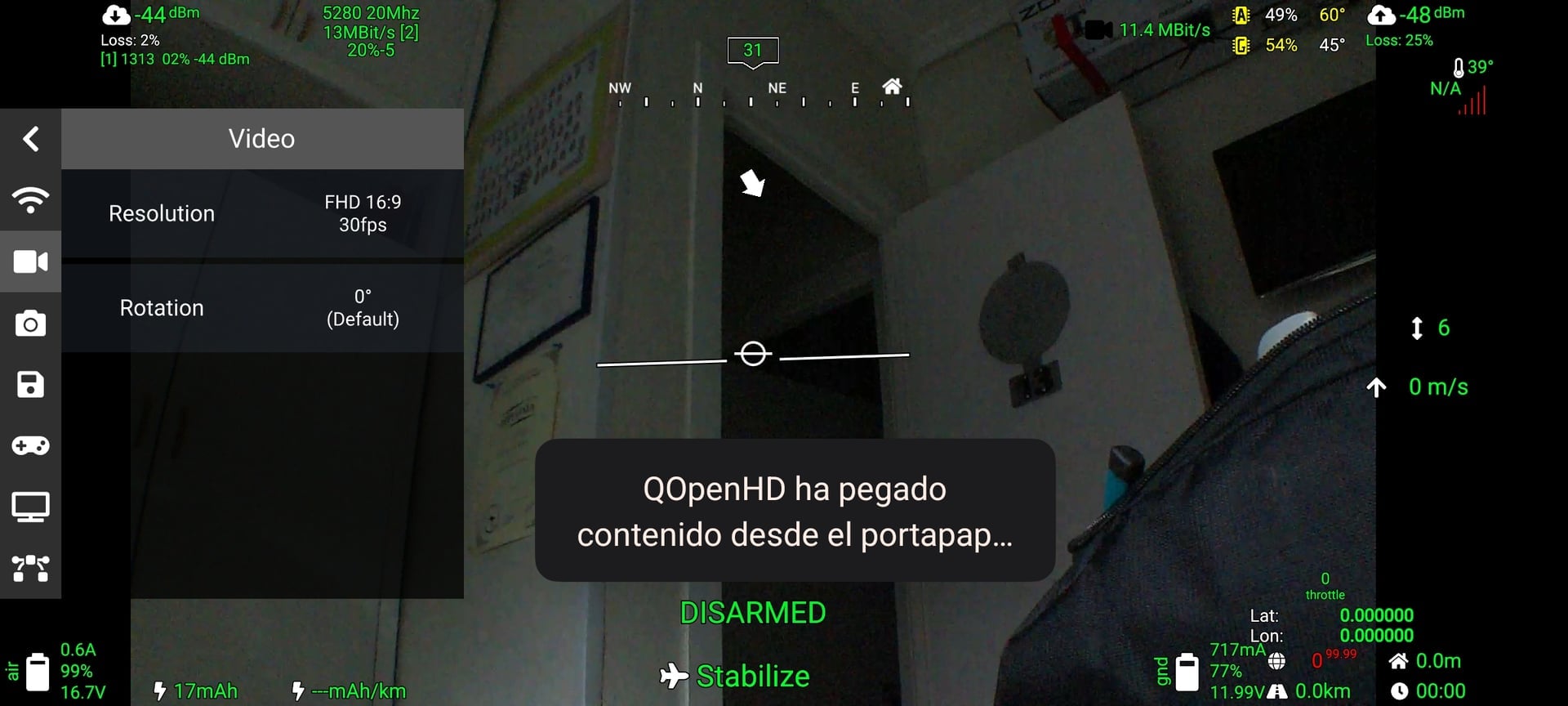

In this tab called "VIDEO" you can select your resolution for the link and also rotate the camera if you wish (the resolution that you set here is also the resolution that is going to be recorded)
VIDEO

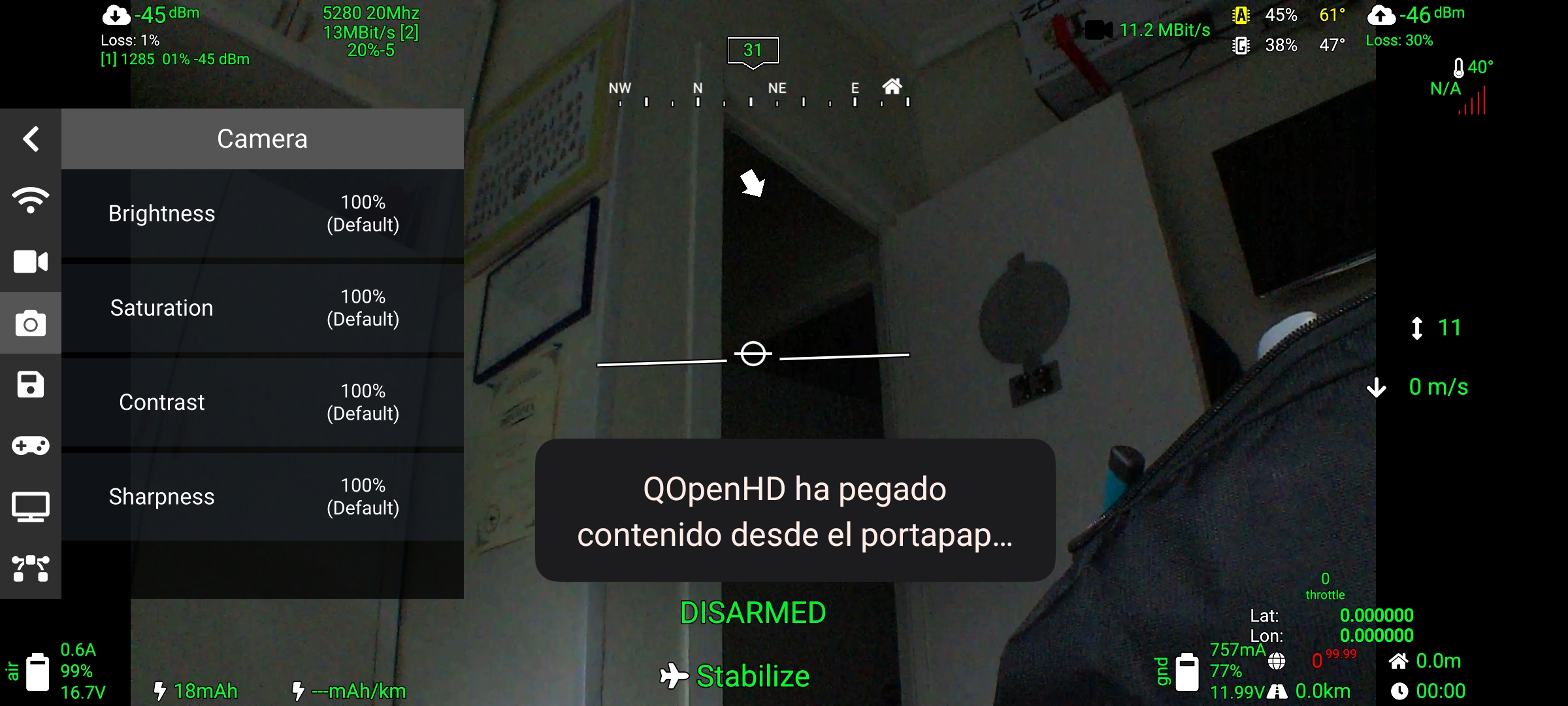

In the thrid tab called "CAMERA" you can change settings of the camera itself like saturation, contrast, sharpness and brightness
CAMERA

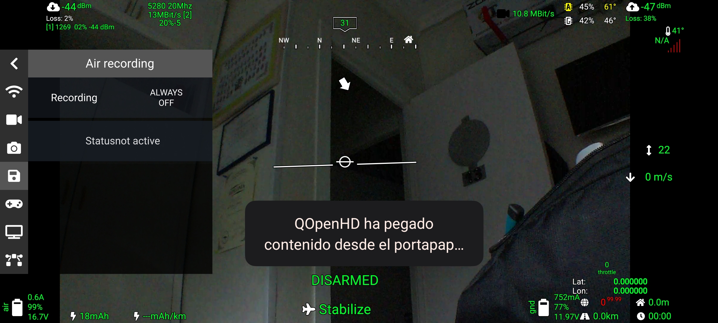

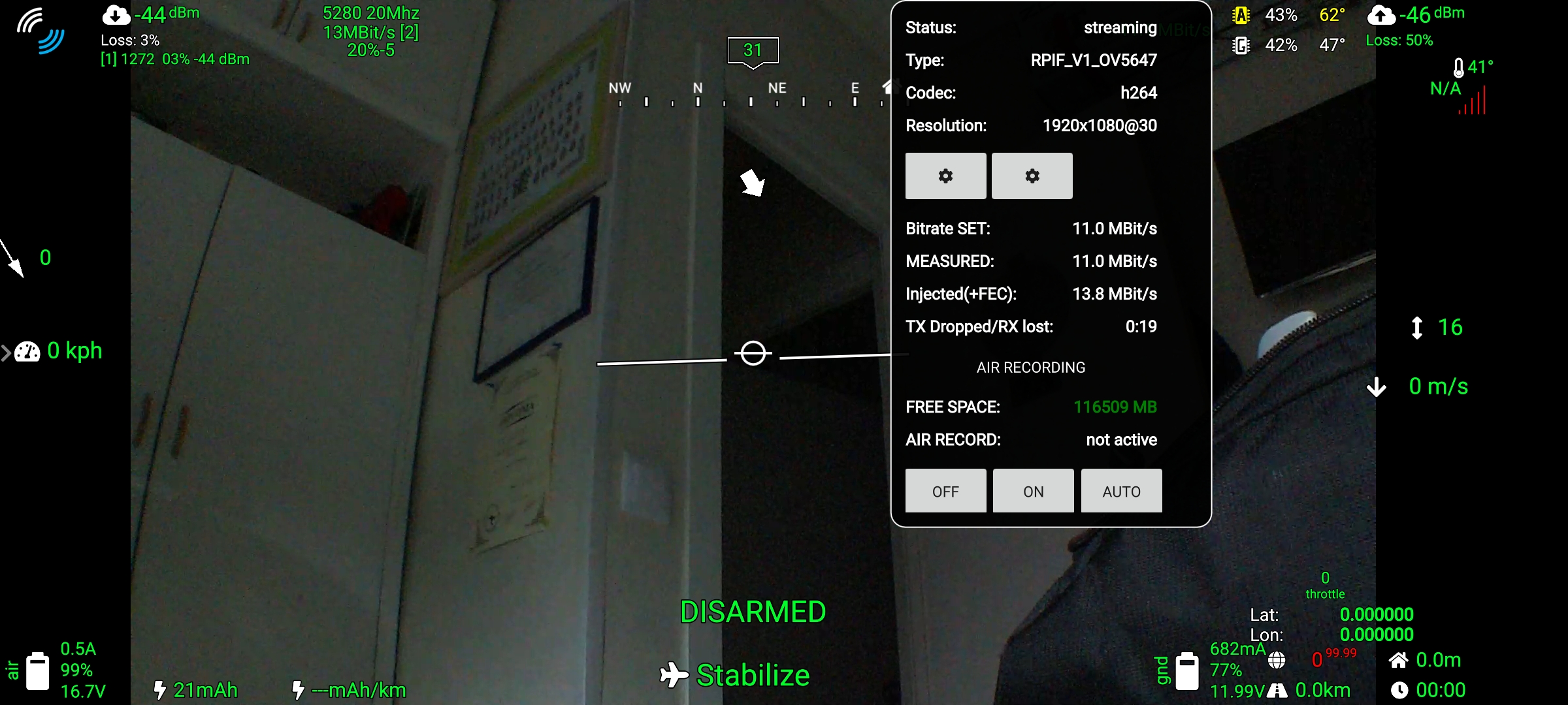

In the fourth tab called "AIR RECORDING" you can change settings regarding the air recording, in EVO we use air recording instead of ground recording like in 2.0 to improve the experience of the recording by removing the possible interference that can be present in the link By deafult is set to OFF but you can set it up ON or AUTO, in AUTO the system is going to start recording at the moment you arm the UAV
AIR RECORDING

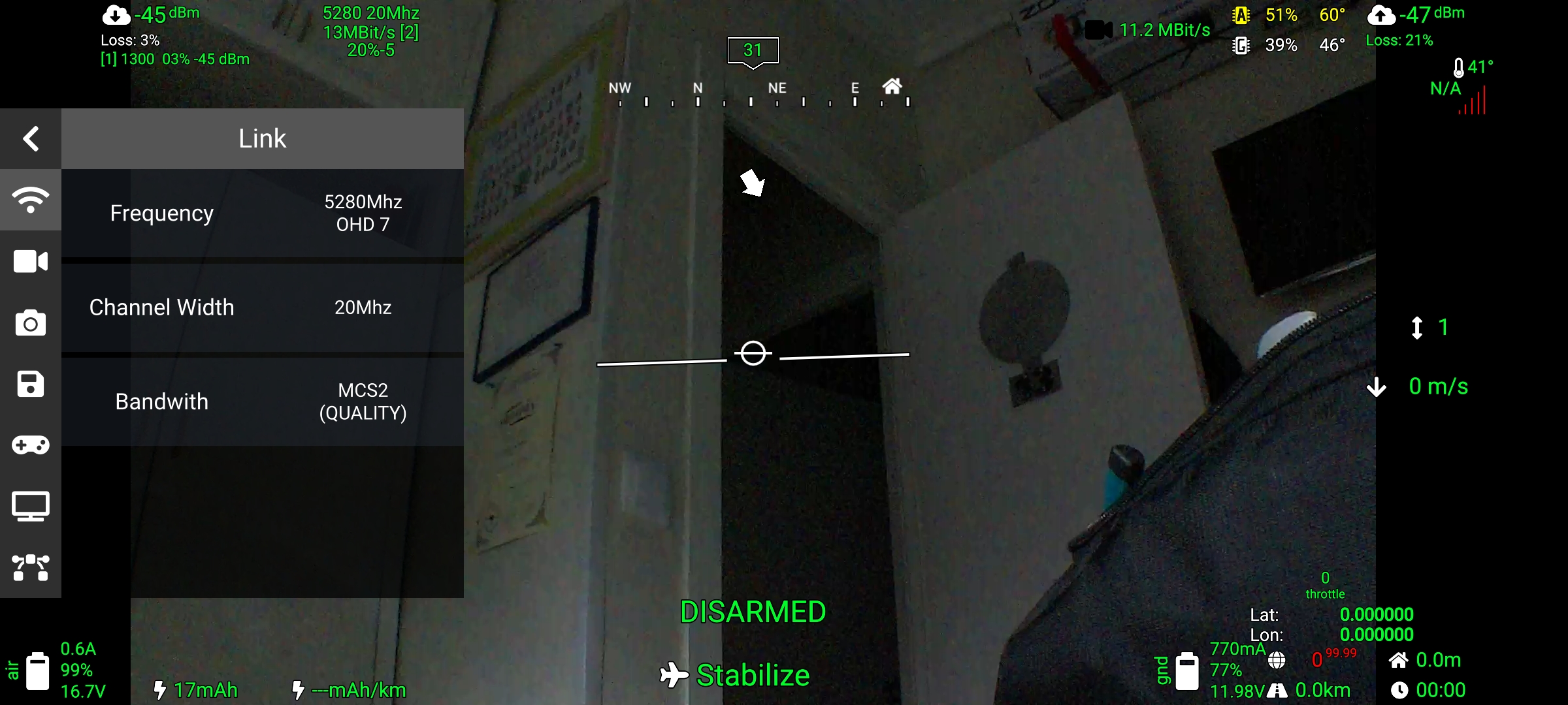

Other very important screen is the one where you can see statistics of the link, to open it click on the red circle
VIDEO STATISTICS VIDEO STATISTICS
