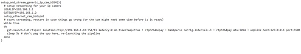

To configure the pipeline to the camera you need to modify the script "custom_unmanaged_camera_old.sh" in air sbc. Rename it to "custom_unmanaged_camera.sh". After that, open the script and you will find different examples of configuration for connection to different cameras. Copy "setup_and_stream_ip_cam_siyi_h264" configuration and rename it to a different name. Now to configure "LOCALIP" and "GATEWAYIP" with the same first 3 numbers as your IP camera IP and with the last number being different in all 3 cases. Then you need to change the stream link in the Gstreamer pipeline command with the correct one of your camera. The configuration should look like this:

At the bottom of the script, comment all the configurations and put the name of the new one you have created and save the file. Finally, open a terminal and execute the following command:
