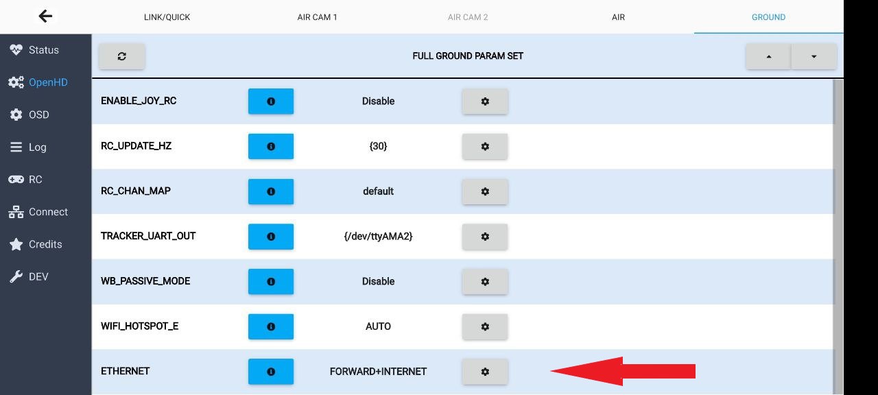

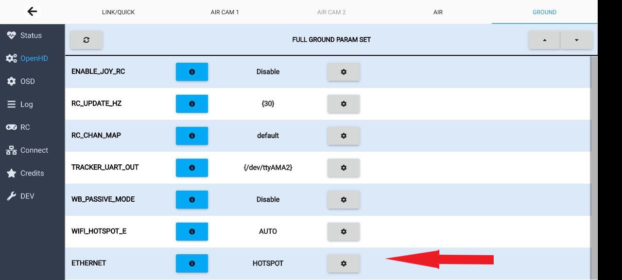

  2. Enter in the Ground tab and here change the settings "Ethernet" from disable to Hostpot or forward+internet, the last one is very handy to give internet to the pc from your phone
Ground settings Ground settings
