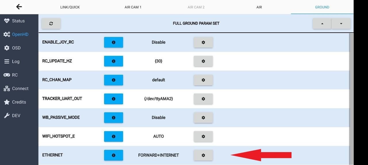

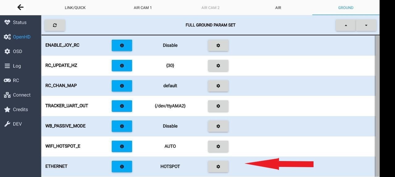

  3. Enter in the Ground tab and here change the settings "Ethernet" from disable to Hostpot or forward+internet, the last one is very handy to give internet to the pc from your phone
Ground settings Ground settings
  1. Reboot ground unit, once you have done this settings you can leave it ON it doesnt interfere with anything

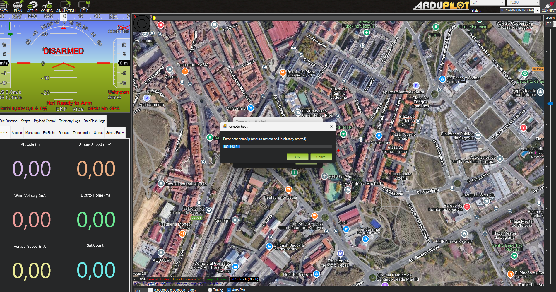

  2. Open Mission Planner and select as method of connection TCP
  3. Once selected a few windows will pop up, in the first one you should enter the IP (192.168.3.1)
IP

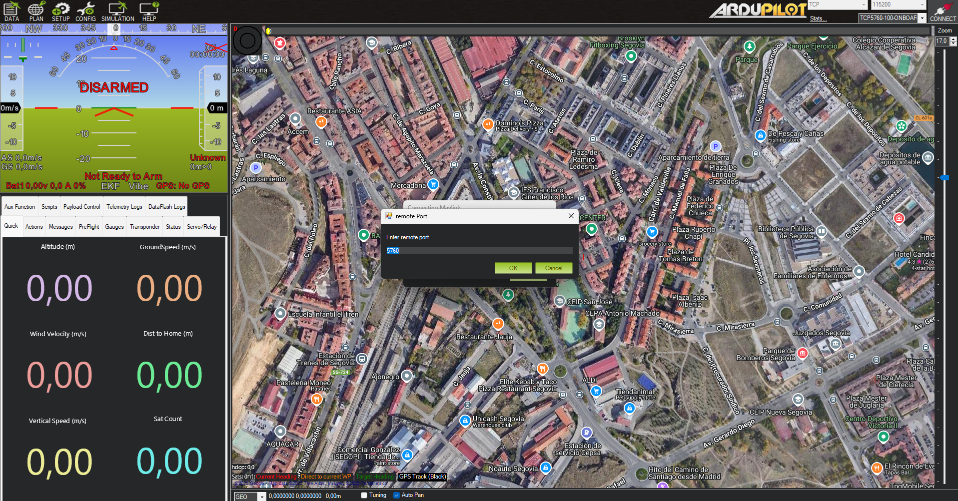

  1. In the next window you have to introduce the port (5760)
PORT

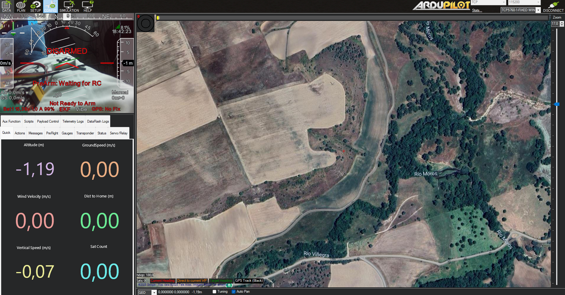

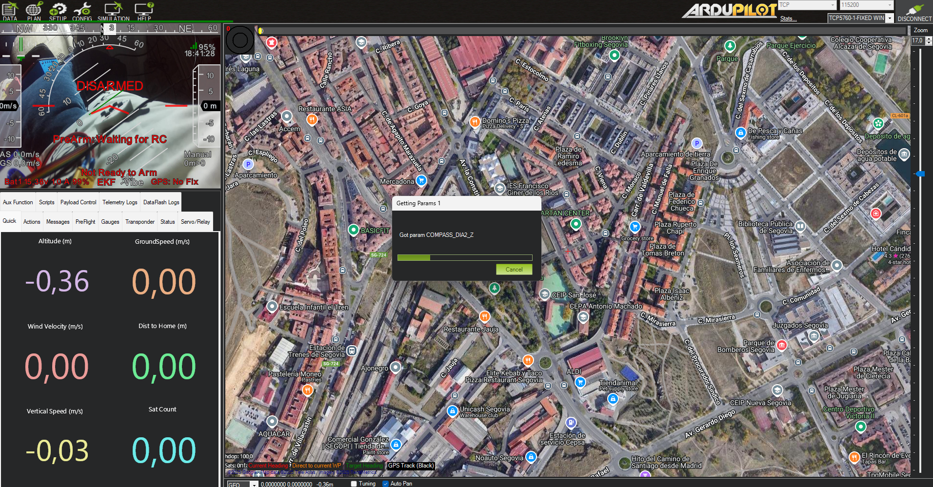

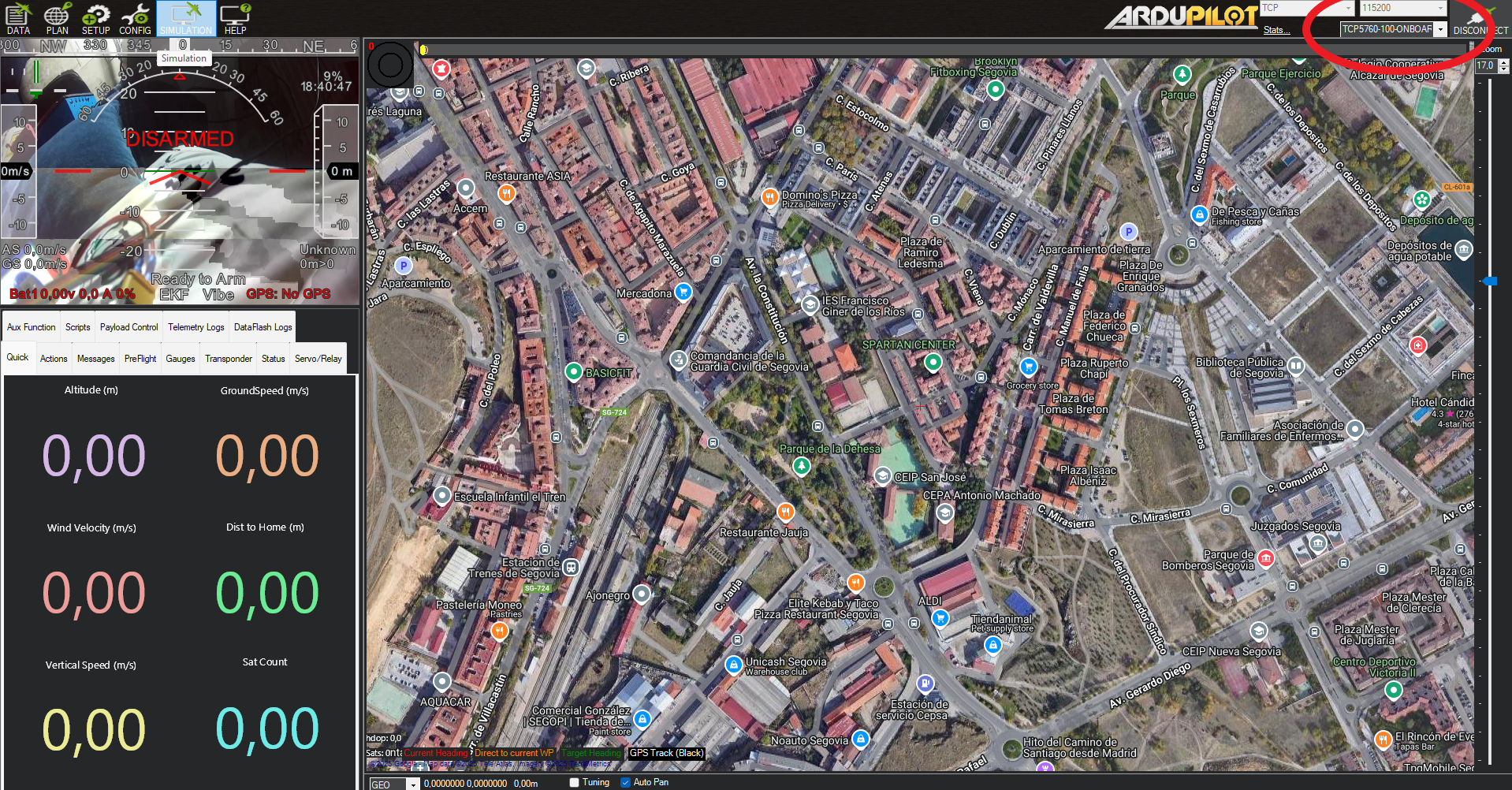

  1. Now you should have video but not telemetry, to solve it you need to press in the drop-down and change it from "onboard" to "Fixed wing"
Video but no telemetry Loading params
  1. Everything should be ready and working
