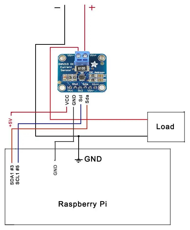

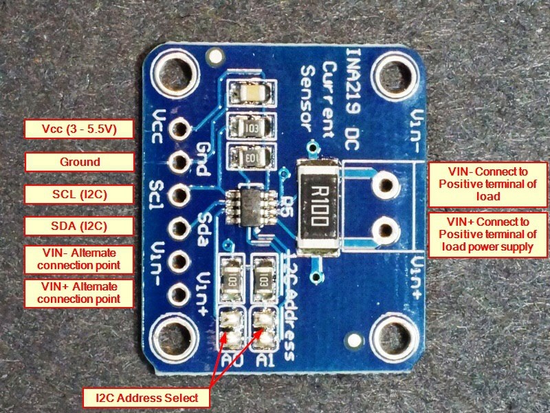

INA219 - Simple and efficient Using the INA219 modules, readily available from sources like AliExpress is a simple and efficient way to add Ground Power monitoring. The module is easy to attach to the Ground unit using I2C. The following pictures and diagrams should be all you need. If the system finds the device attached it will automatically enable the functionality.
Wiring INA219
PINOUT INA219

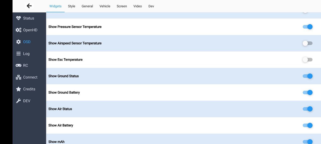

By default is OFF you need to turn on the widget on the OSD tab, its called "Show ground battery"
OSD settings
