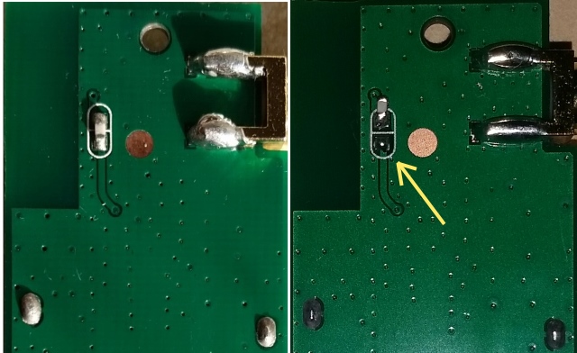

TL-WN722N V1​
This adapter will provide around 60mW output power. Range should be roughly around 800-1000m with 2.1dbi stock antennas.
NOTE: There have been reports that the TL-WN722N V1 seems to be replaced by V2 and V3 versions. These new versions use a completely different chipset and are not compatible. Consider asking the seller for the version, if it says "V2" or "V3" on the back of the dongle it's the wrong chipset!
NOTE: The PCB antenna causes packetloss and bad reception under certain circumstances. It is recommended to disconnect the antenna by moving the SMD component as shown below:
