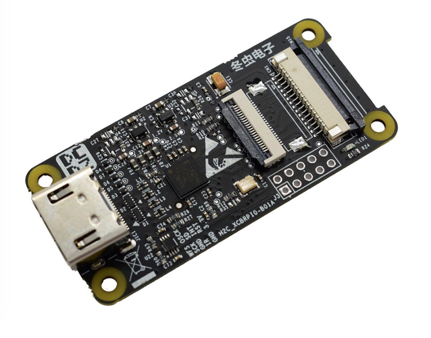

DCDZ HDMI CSI-2 adapter​
AliExpress link: DCDZ HDMI CSI-2 adapter
Very widely used for OpenHD, but only available through AliExpress and Taobao, so those of you in the U.S. or Europe may have trouble getting them quickly. See the similar geekworm board below, those are available on Amazon.
Has a connector for both the Raspberry Pi Zero and full size Raspberry Pi models, none of the other cards do.

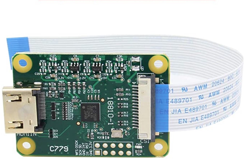

Geekworm HDMI CSI2 adapter​
Available on Amazon in the U.S., and is similar to the DCDZ adapter above.
Amazon store: Geekworm HDMI CSI2 adapter
Geekworm store: Geekworm HDMI CSI2 adapter
Has a connector compatible with the full size pi models.

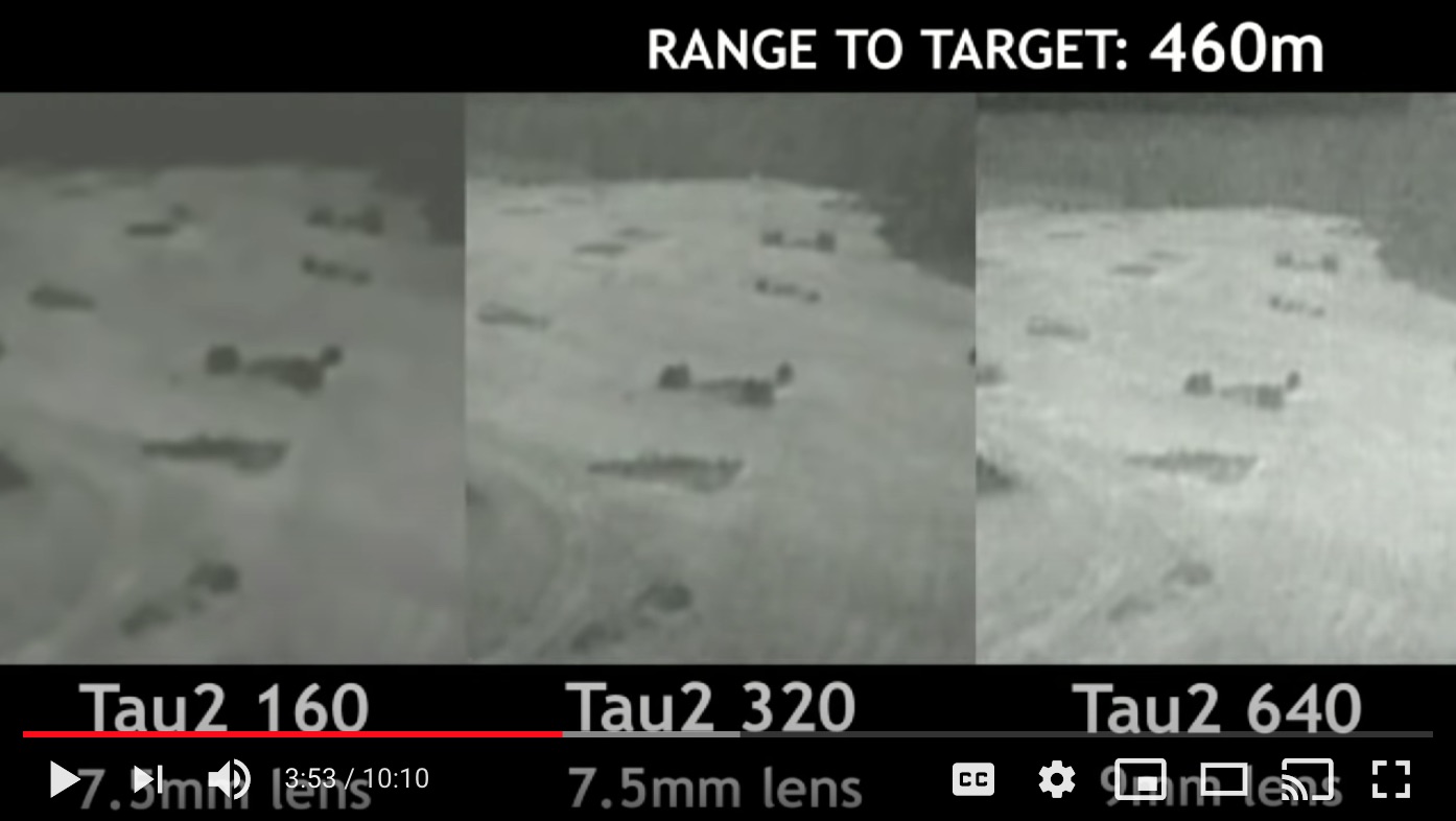

Flying with a thermal camera​
You will want to give some consideration to what you will actually be able to see with a specific thermal camera in a particular situation.
Very low resolution thermal cameras may allow you to see that a hot object is in a particular area, but you may not be able to tell what it is. In some cases like search and rescue, this may be perfectly fine, but in other cases you may need higher thermal resolution.
Remember we're talking about sensors with very low resolution to begin with, for example a 1280x720 FPV camera has 48x the resolution of a 160x120 thermal camera. At longer range you may not even be able to see an object at all, even if you can still see it with the main FPV camera.
Another consideration is the thermal "span" of the area in view of the thermal camera, if the ground is the same temperature as the trees, objects and animals (for example they're all around 97F), you will have trouble seeing anything but noise or a flat image with many cameras. In that case you would need to look for a camera with a low NETD rating, and a good sized lens.
FLIR Tau 2 and range test

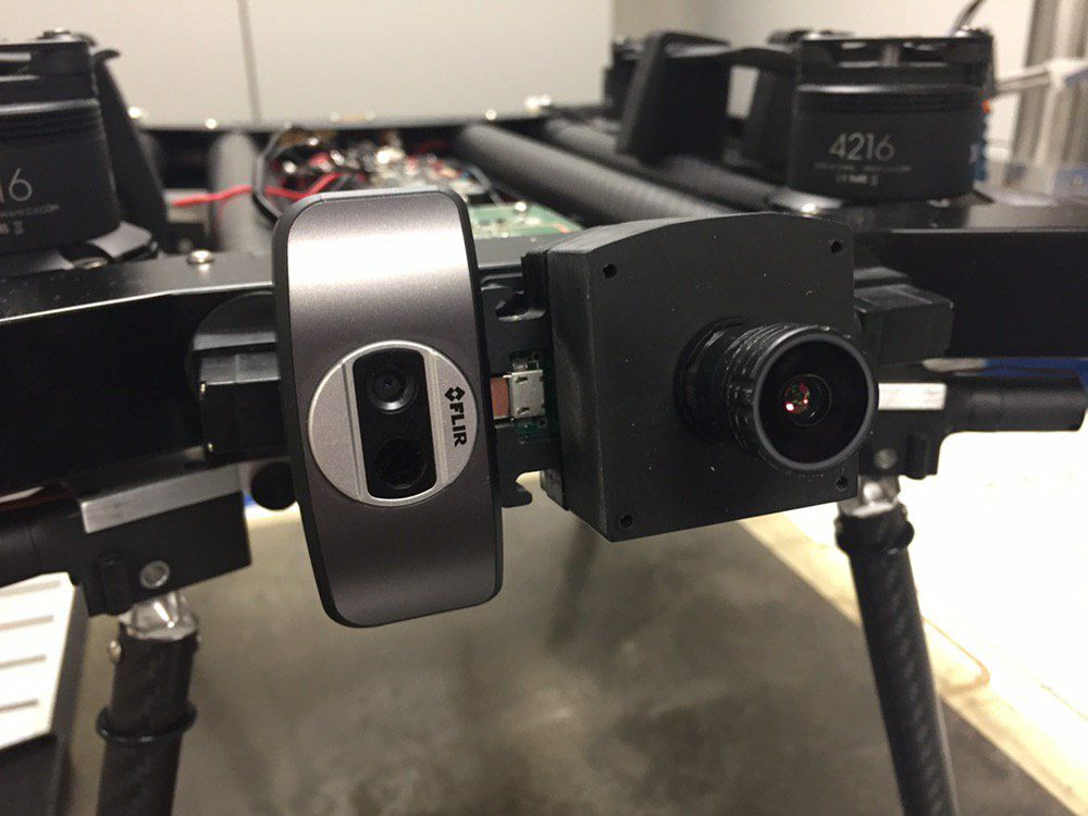

FLIR One G2​
flir one g2
These are designed to connect to a smartphone, there were iOS and Android versions with different connectors. The Android version has a standard Micro USB connector and can be connected to an OpenHD system with a USB OTG cable.
Many people use these cameras, they are well known and they do work, despite the low resolution and thermal performance.
The resolution is 160x120, which is the absolute minimum you would want for drone flight. You will be able to see heat signatures but without much detail.
The sensor inside the FLIR One G2 is a FLIR Lepton 3 (confusing, yes), which is a very good thermal image sensor. However FLIR's lens and image processing choices reduce the image quality.

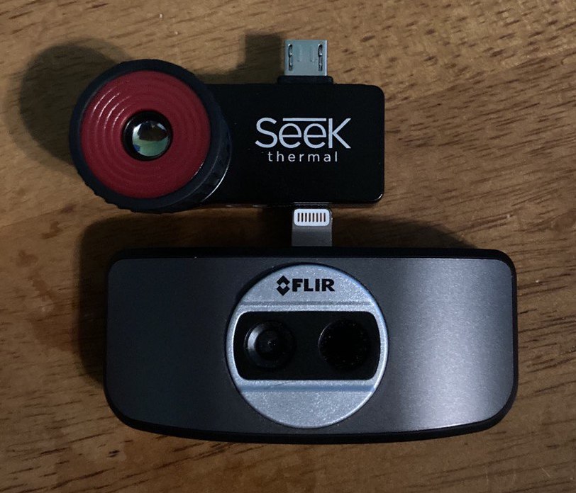

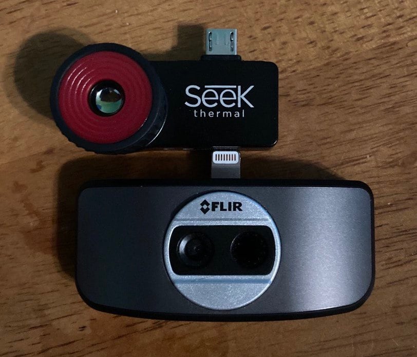

Seek Compact Pro (manufacturer, Amazon)​
seek compact pro compared to flir one g2
Model numbers for these cameras do not end with an X, e.g. UQ-AAA.
These are significantly better than the non-pro model, the sensor is 320x240 and has a Chalcogenide lens.
There is still a fair amount of noise in the system, these are better for scenes where there is a big difference/span between the hottest and coldest object in view. When the thermal span is small, the noise in the system can become very obvious.
Note that Seek has quietly updated these cameras over time, so you may have one that works more like a FastFrame even though it wasn't marketed that way when purchased. They have also made some improvements to the sensor and firmware over time.

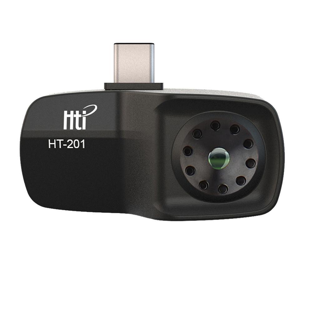

Hti-201 (manufacturer)​
Hti-201 Thermal Camera
These are basically clones of the Seek Compact Pro.
The camera housing has a very awkward shape compared to most other thermal cameras, the side with the sensor and lens has a significant bump.

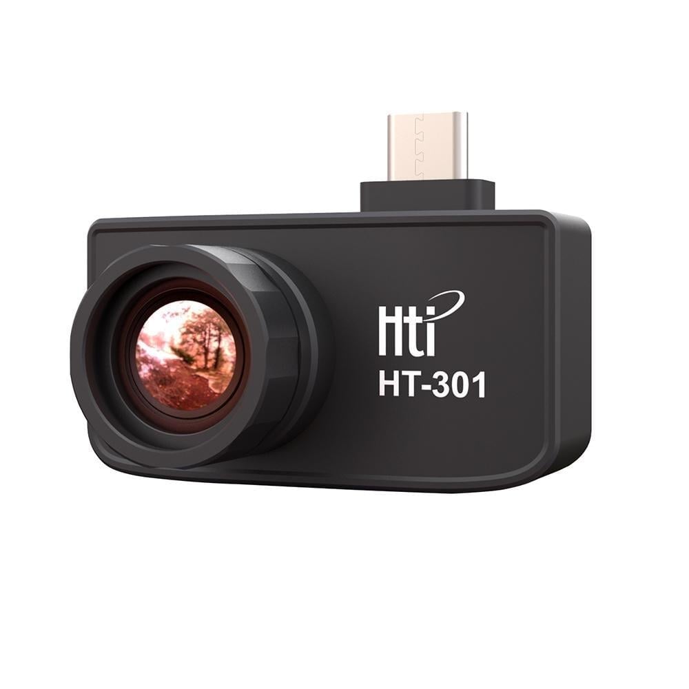

Hti-301 (manufacturer, Amazon)​
Hti-301 Thermal Camera
A very good thermal camera with 384x288 resolution and a fairly large germanium lens and a frame rate of 25hz. They are expensive compared to some others, but the thermal performance is very good.
These cameras are designed to work like a normal webcam, in that there is no special driver required.
Note that you may have trouble getting 25hz video streams out of these when used with a raspberry pi due to USB limitations.

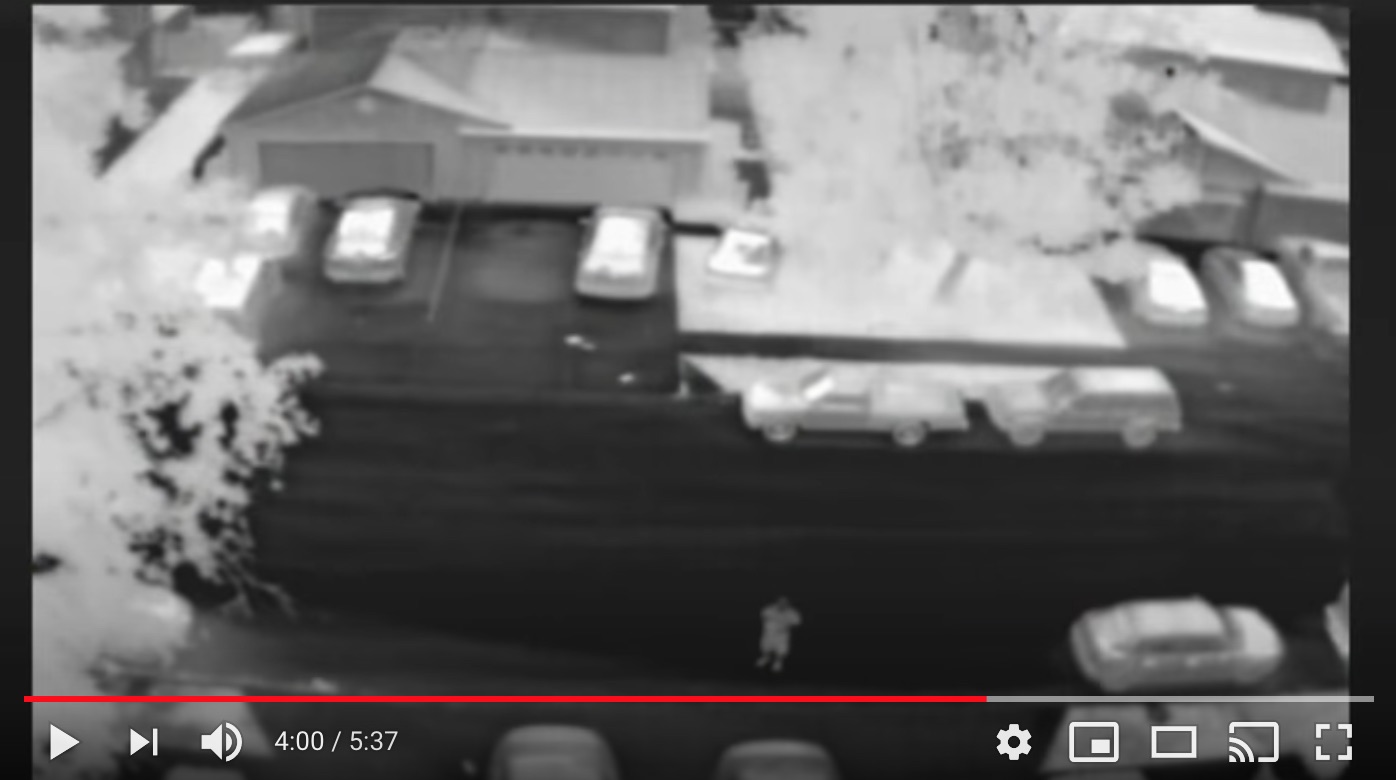

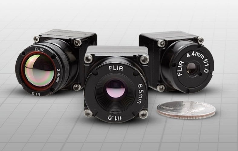

FLIR Boson 320 (manufacturer, GroupGets)​
FLIR Boson 320 Thermal Core
A 320x256 thermal imager "core", full 60hz frame rate but FLIR makes a 9hz version as well. They are fairly expensive but have Germanium lenses.
Unlike most of the other cameras these are not designed for a smartphone, they are designed for integration in something like a larger camera system or a drone. You must buy an appropriate connection board to snap on to the back of the camera, some have USB while others have analog video output. For OpenHD you would want the USB kind, analog video requires a special adapter to digitize it again and most of them will not work well with a raspberry pi.
These are export controlled items due to the very high frame rate.
Note: as of the time this wiki page is being written, I am not aware of anyone having used a Boson with OpenHD, there may be some changes required in software to make them work.
Real world flight video:
FLIR Boson 320 flight
