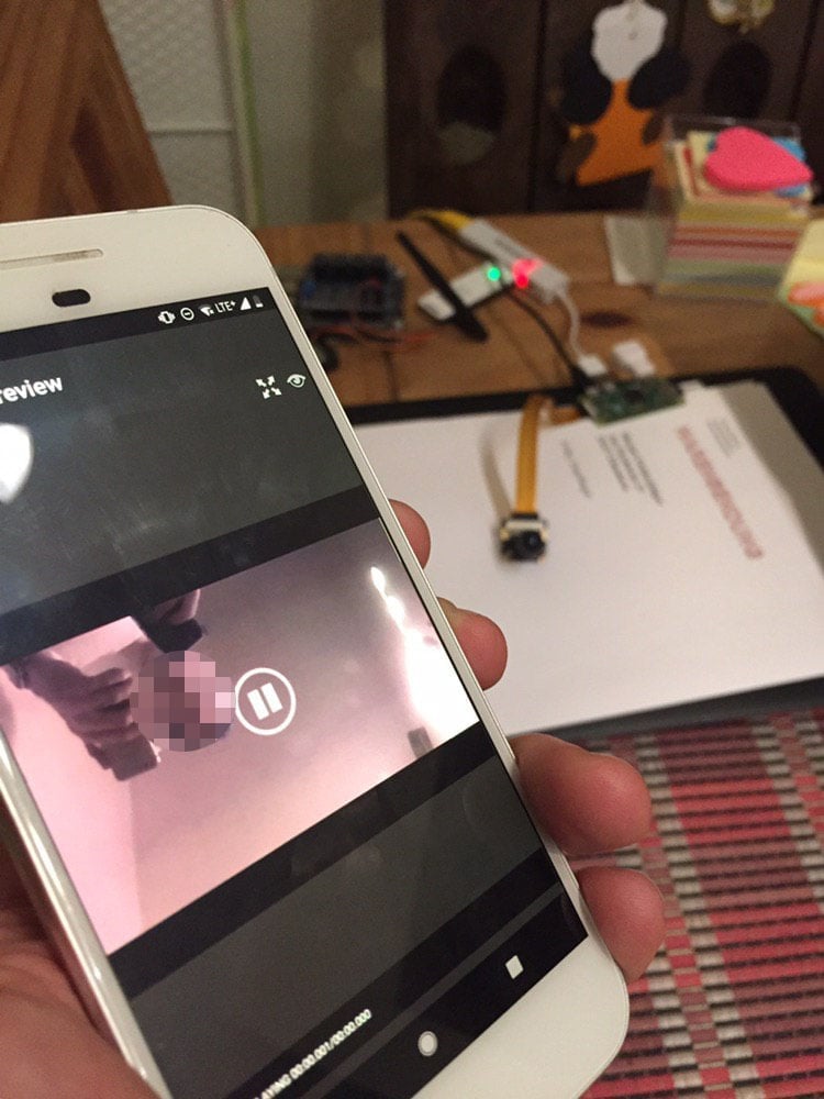

Connect your device either via USB Tethering, Wifi-Hotspot or Ethernet-Hotspot to the GroundPi.

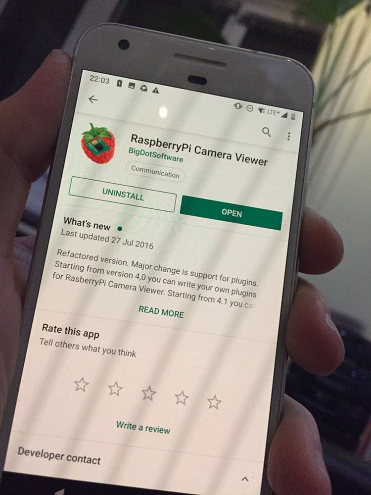

Android​
RaspberryPi Camera Viewer

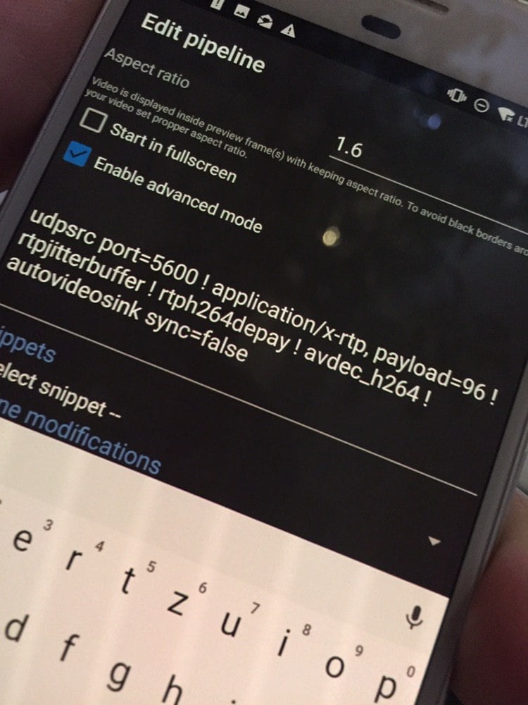

  • Click on the "+" Icon to create a new camera preset (on the bottom right)
  • Next choose "Enable advanced mode" and enter the following gstreamer pipeline:
    udpsrc port=5600 ! application/x-rtp, payload=96 ! rtpjitterbuffer ! rtph264depay ! avdec_h264 ! autovideosink sync=false
