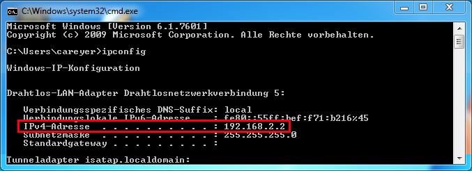

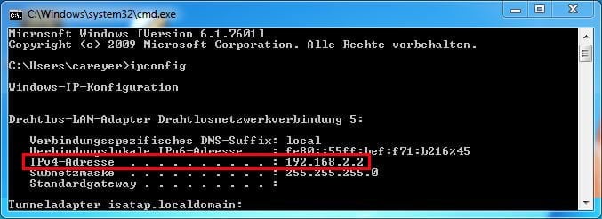

  5. Next we are going to find out the IP of our GroundPi. Type ipconfig -> press Enter Watch out for the IP-v4 address of your PC's Wifi adapter. It should read something like: IPv4 address.....: 192.168.2.2 - Awesome! This address -1 on the last address block is the IP address of your GroundPi: i.e. 192.168.2.1 MissionPlanner_BiTelem_02.JPG

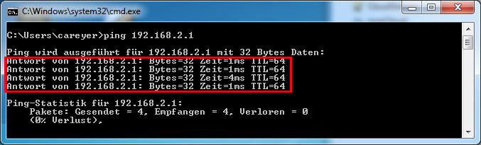

  6. Let's see if we can Ping that thing. Type ping 192.168.2.1 -> Press Enter. Are you getting a reply? Perfect! MissionPlanner_BiTelem_03.JPG

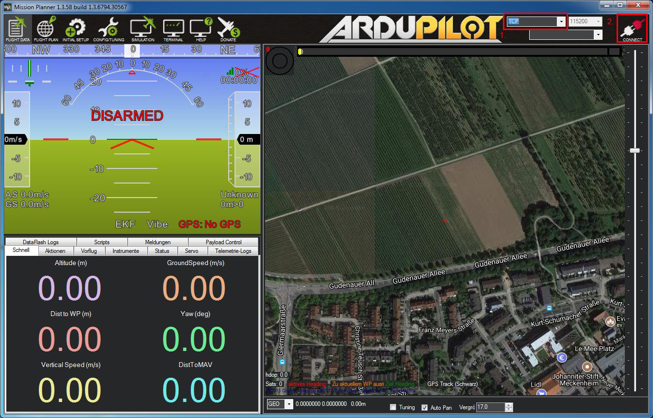

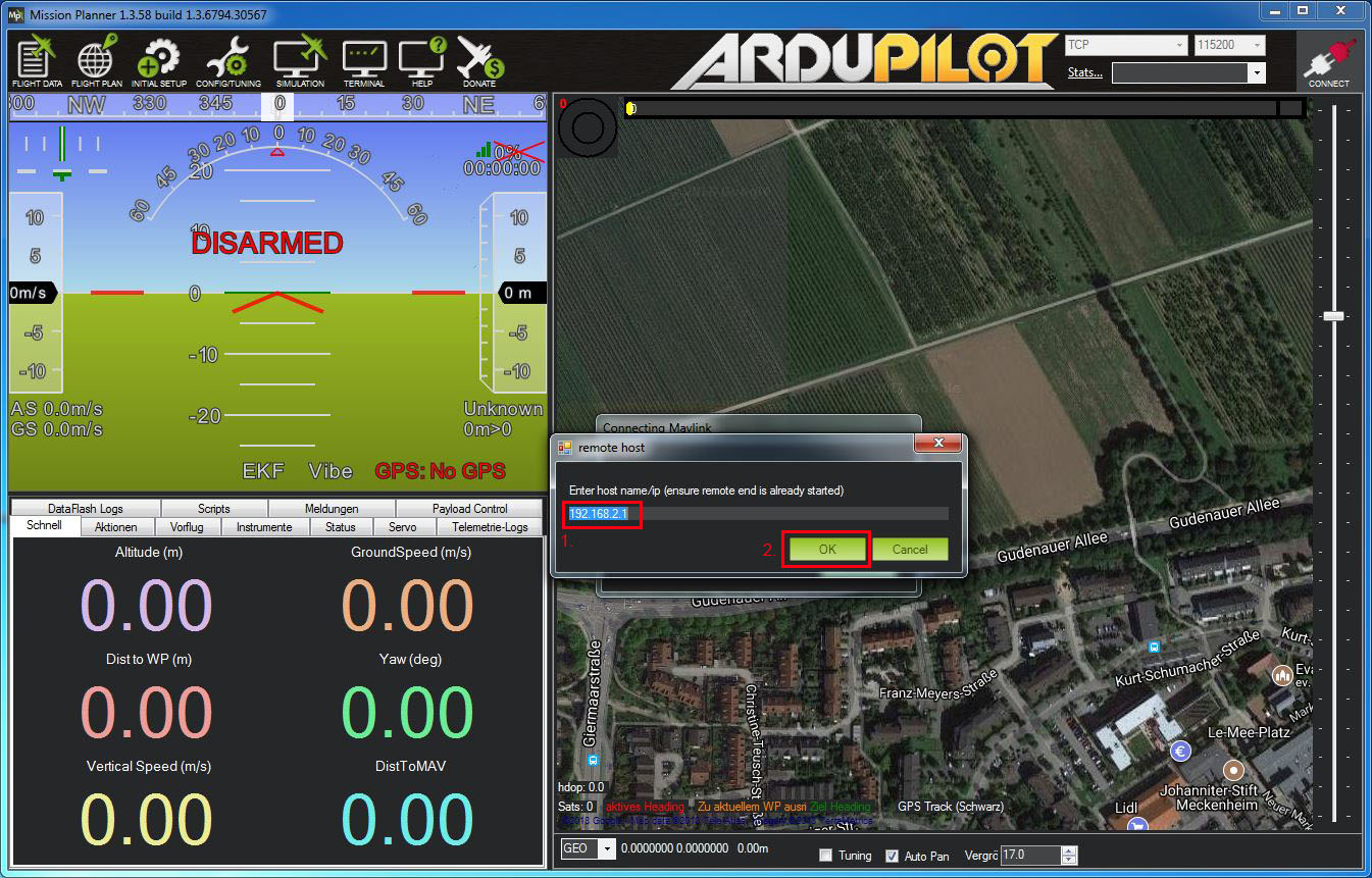

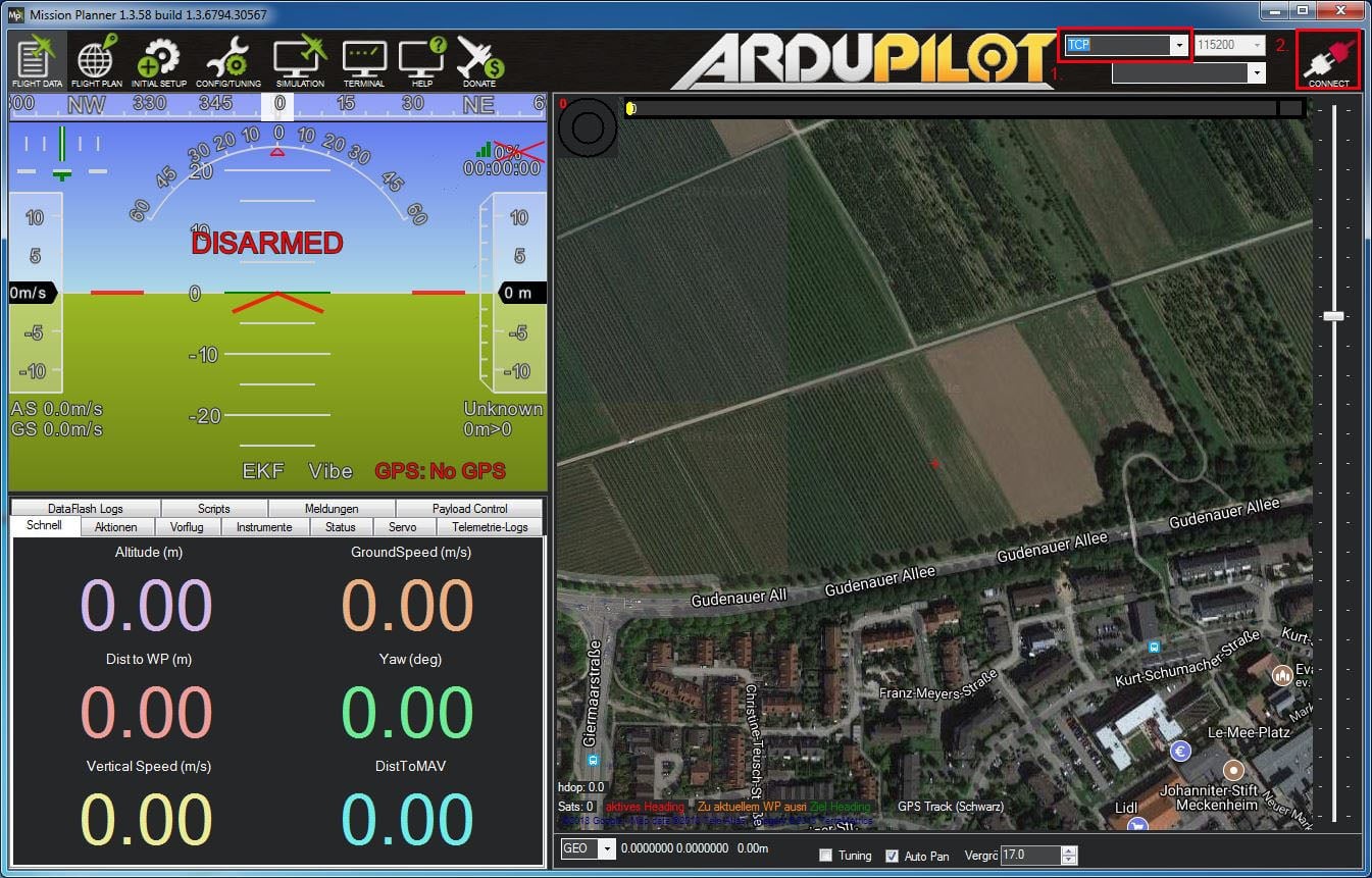

  7. Now start MP and choose TCPas the method to connect. Press the Connect Button MissionPlanner_BiTelem_04.JPG and enter the IP of your GroundPi in the upcomming dialogue window: 192.168.2.1. MissionPlanner_BiTelem_05.JPG Next select the port (nothing needs to be changed - the default is: 5760) MissionPlanner_BiTelem_06.JPG

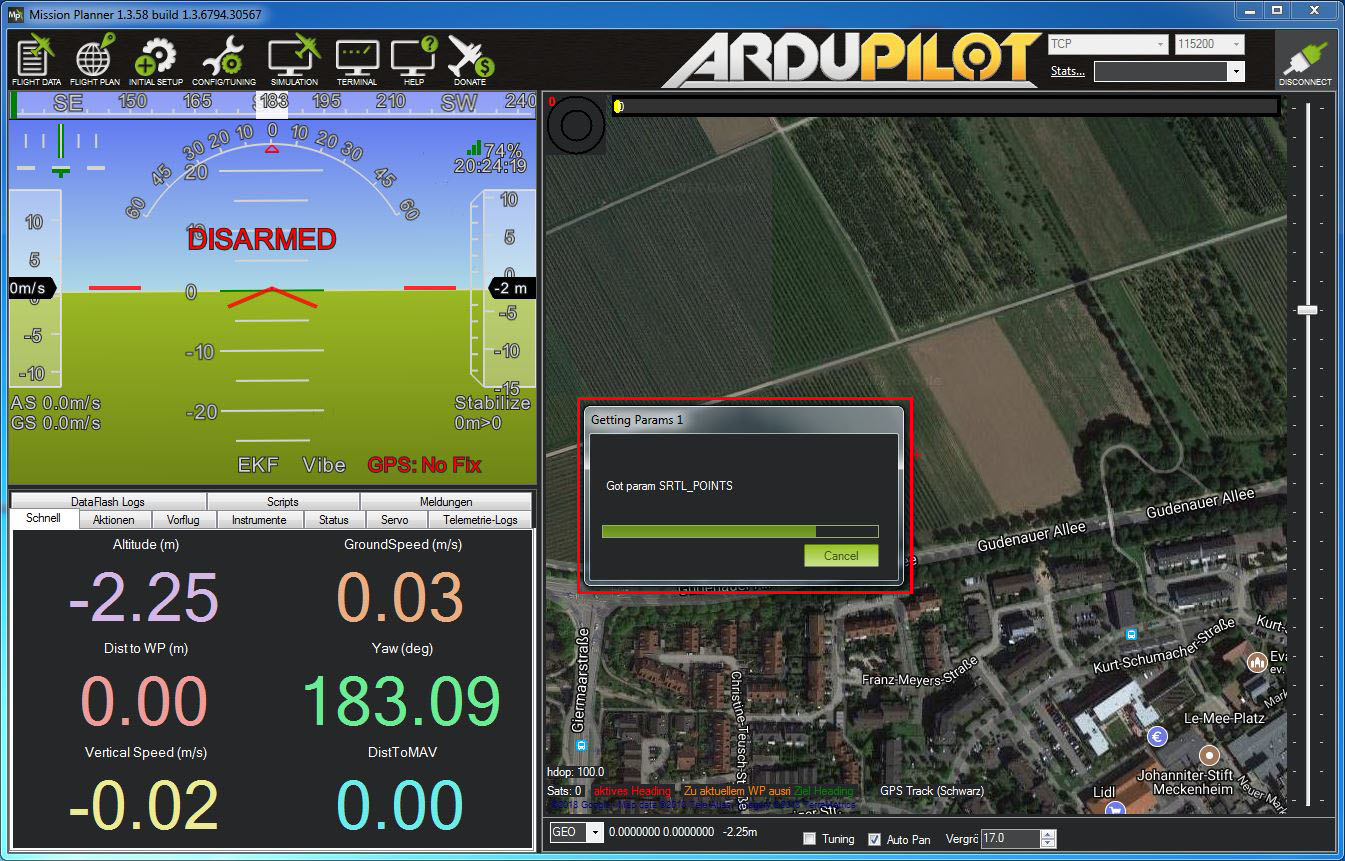

  8. Now! Here we are! - Your MP should now happily connect to your Flight Controller (FC) through the OpenHD radio link. Once the initial parameter set has been transferred you can either enjoy your fancy real time telemetry or go ahead and configure your autonomous vehicle in-style. MissionPlanner_BiTelem_07.JPG

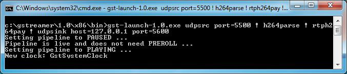

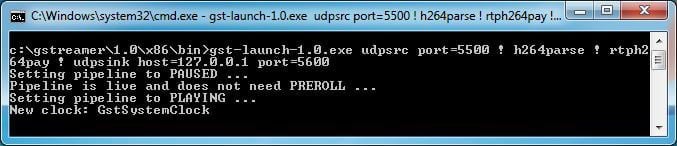

  7. Change to the C:\gstreamer\1.0\x86\bin directory and type the following command (you can put this in a *.bat batch-file later on): gst-launch-1.0.exe udpsrc port=5500 ! h264parse ! rtph264pay ! udpsink host=127.0.0.1 port=5600 MissionPlanner_VideoHUD_01.JPG

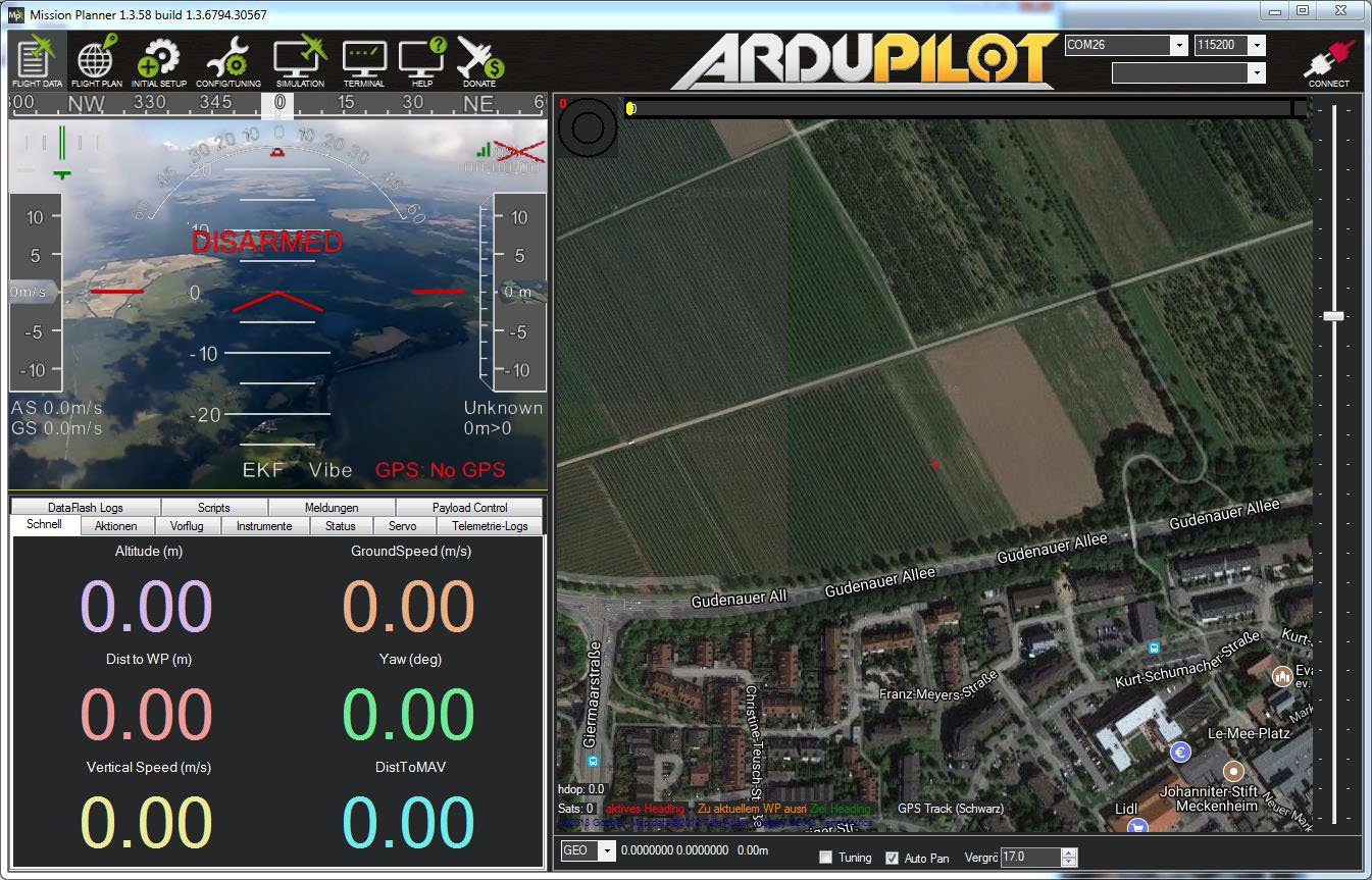

  9. After the restart your live HD-video stream should show in the HUD window. MissionPlanner_VideoHUD_03.JPG
