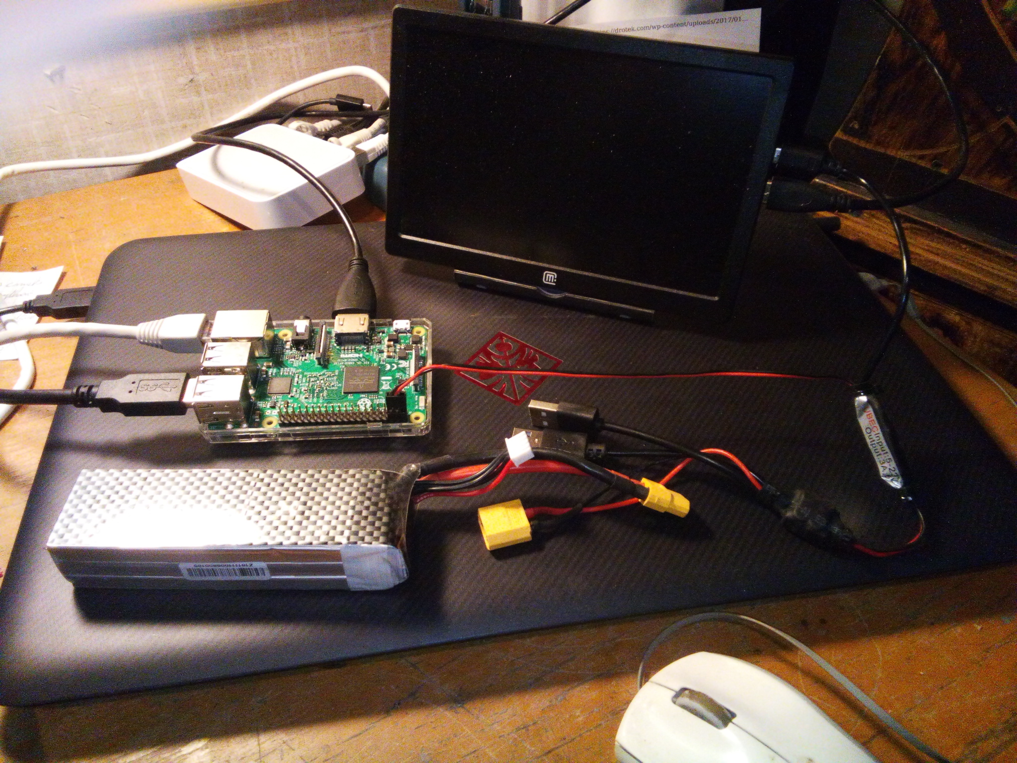

Step 1: Powering the Ground SBC​
This is where the BEC's come in. Much like the Air SBC, the Ground SBC will likely be powered by a LiPo battery. The Raspberry Pi and the WiFi cards all use 5V, which is what most BEC's produce. So hook up one of your SBC's to a LiPo battery and use a multimeter to double-check the output is +5V.
info
The Raspberry Pi and most WiFi adapters actually like the voltage to be slightly higher than +5V, along the lines of 5.2V ~ 5.4V. If you have a variable output, best set it to +5.3V. Do not go higher than +5.4V or you will damage your Raspberry Pi and/or WiFi cards!

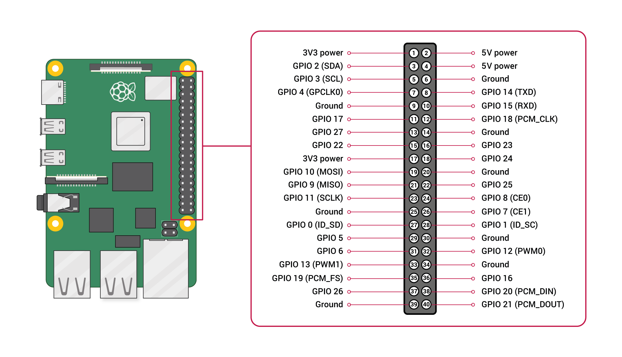

When you have verified the output of the BEC, we can connect it to the Raspberry Pi, to do this, we have two options. Soldering or using the GPIO Pin Header, for the Ground SBC it's OK to use the GPIO Pin Header, for the Air unit we recommend soldering. Connect the output from the BEC to the PI on pins 2 and 6 (or 4 and 6) according to this diagram:
Raspberry Pi GPIO header pins
This can be done easily by just plugging in the Servo header that comes with most BECs into the Raspberry Pi Pin Header. Make sure the RED wire is connecting to Pin 2 or 4 and the BLACK wire is connecting to PIN 6. Now when you connect power to the BEC, the Raspberry Pi will power up!
Raspberry Pi Powered from Pin Header

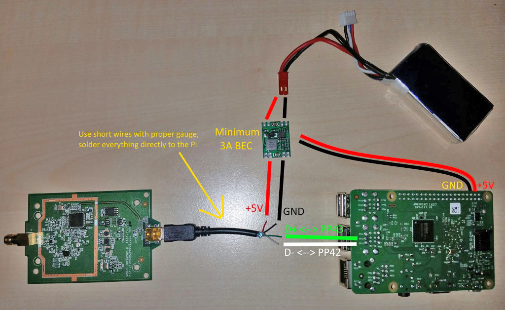

Now that we have power going to the Raspberry Pi it's time to complicate things. Attaching WiFi cards should be as easy as plugging them into the Pi's USB ports, unfortunately it isn't. Due to the way the Raspberry Pi is designed the USB ports do not receive enough power to drive the WiFi cards, especially when connecting more than one WiFi card as is often the case on a ground station.
So we need to make sure we provide enough power to the WiFi card while still attaching it to the Raspberry Pi's USB port. There are several ways to do this, including using a USB HUB and powering that from the BEC. Take a look at Wiring for inspiration. For this step-by-step we will create a modified USB cable.
The basic diagram we want to achieve for this step
Using the diagram above create a USB cable with the D+ and D- soldered to the Raspberry Pi and the +5V and GND soldered to the BEC.
danger
While it may seem tempting to solder the +5V and GND to the solder points on the Raspberry Pi, doing so is not OK! We will be feeding +5V into the circuit of the Pi where this is not intended, probably destroying the USB controller. Make sure the +5V wire of the USB cable is no longer connected on the Pi side. GND is OK connected or unconnected to the Pi.

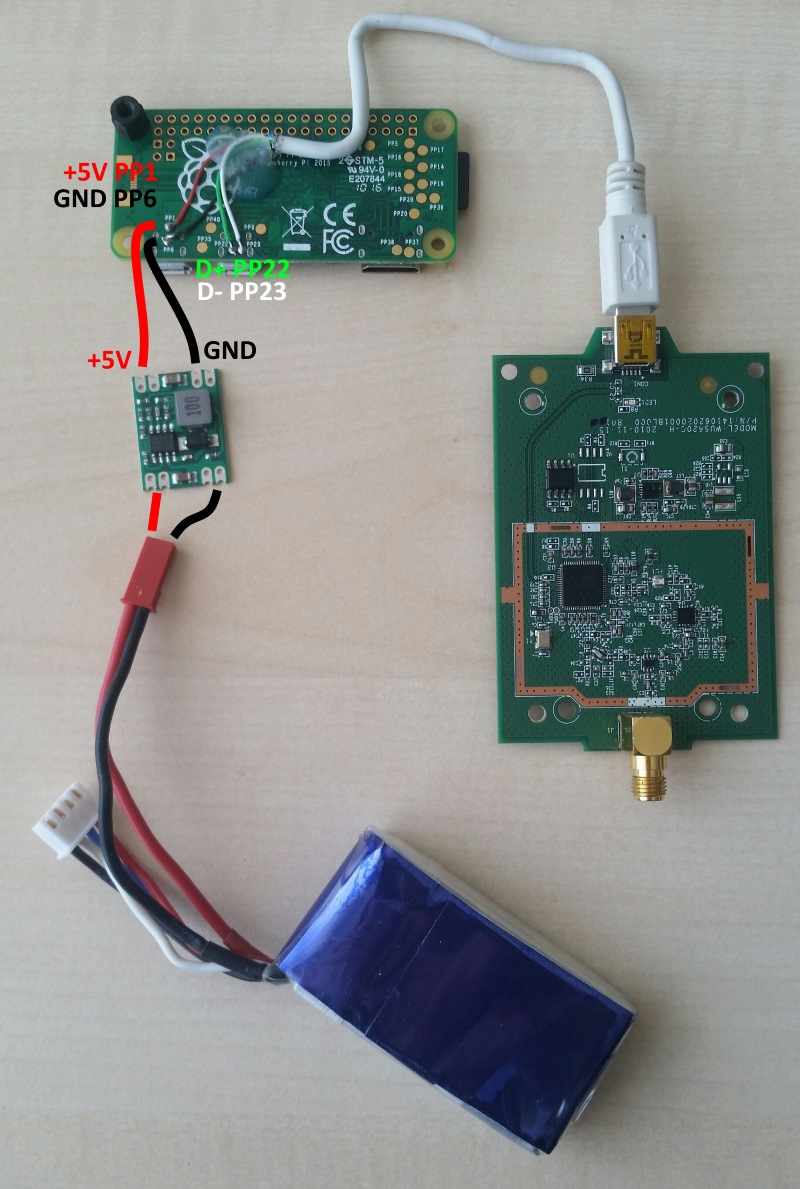

Power for the Air SBC is much like powering the Ground SBC. So use the steps described there to make sure you hook up an BEC with enough Amps to the Air SBC. Please try to solder as much of the connections that you can, soldering will prevent many troubleshooting steps later on.
Since it is quite common to use a Raspberry Pi Zero for the Air SBC here are some schematics for hooking up power AND connecting the WiFi card to that SBC.
Properly wired Raspberry Pi Zero
As you can see both the USB Cable and the Pi are fed power from the BEC.
danger
Please make sure the USB connector on the WiFi Adapter side is also secured, some people solder the USB connectors together, some people use glue, whatever you do, make sure it can not wiggle or disconnect. Even an tiny wiggle might temporarily disconnect the WiFi card resulting in a complete loss of signal from the Air SBC.

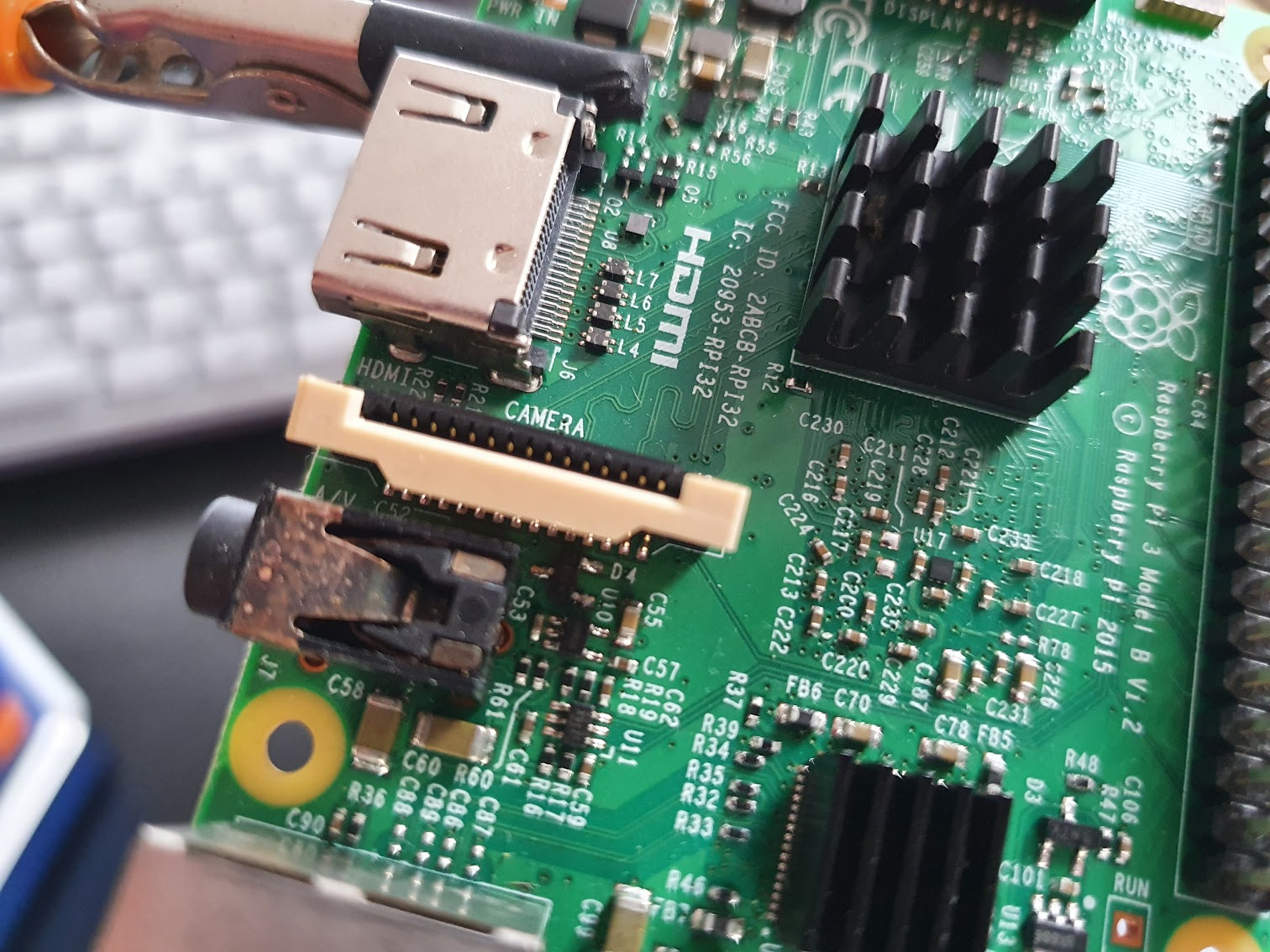

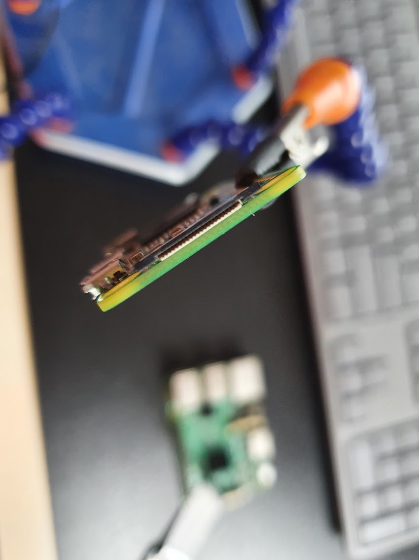

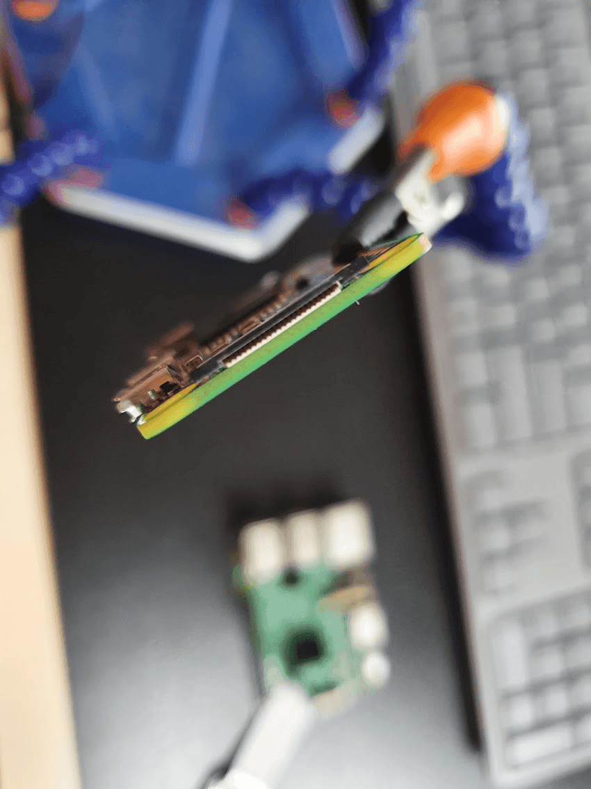

We will now attach the CSI camera to the Air SBC, this is a very simple procedure, but you need to make sure to connect the cable 'the right way around' on both ends. First let's take a look at the ports on the Raspberry Pi's.
The Raspberry Pi Zero CSI connector, notice the pins are on the side near the PCB
The Raspberry Pi 3B CSI connector, notice the pins are facing away from the white locking tab

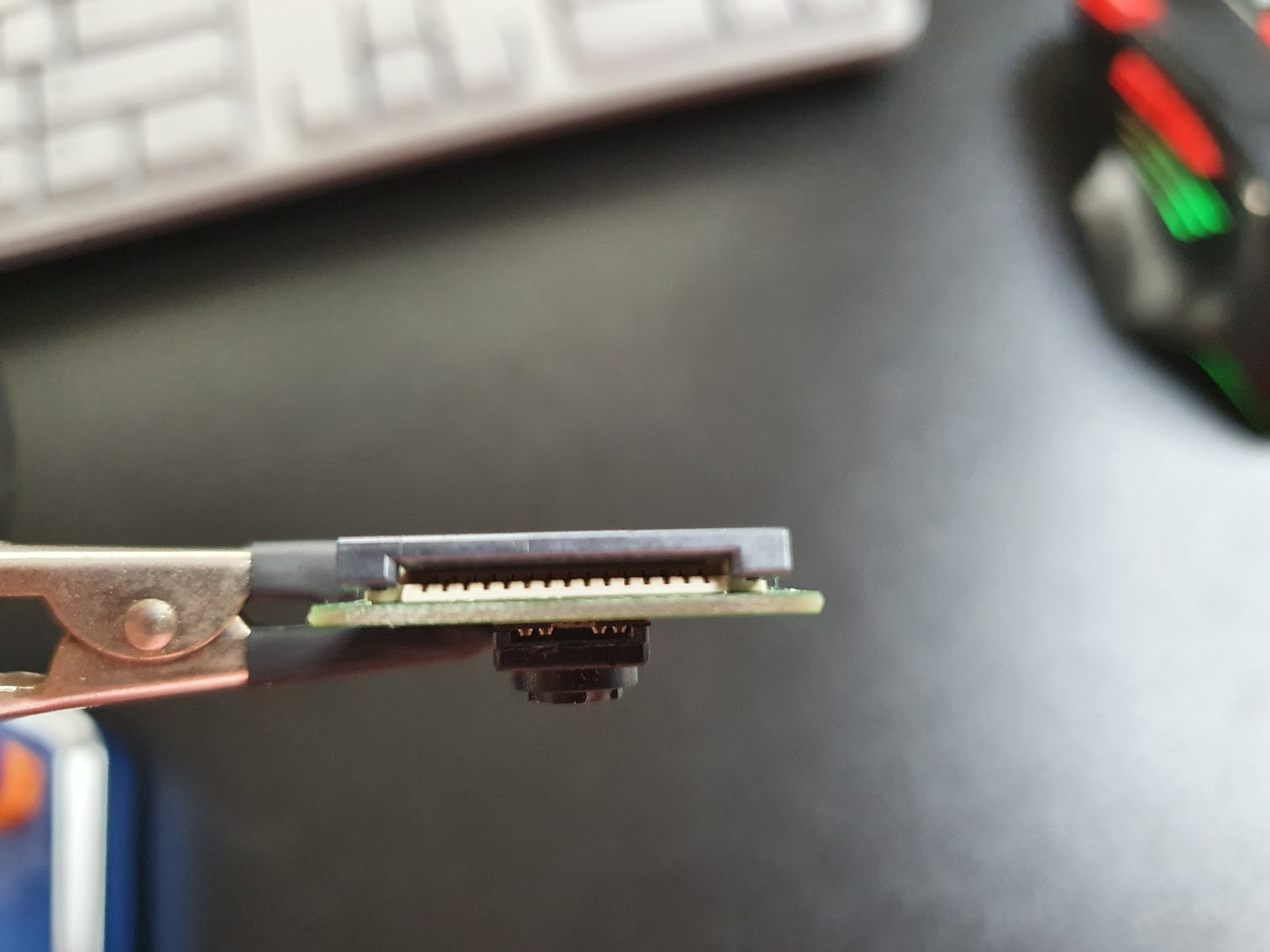

The pictures above should make it clear how to inspect the camera, but for good measure, here is the connector on the camera side:
The Raspberry Pi V1.3 Camera board connector, notice the pins are on the side of the PCB (white part)

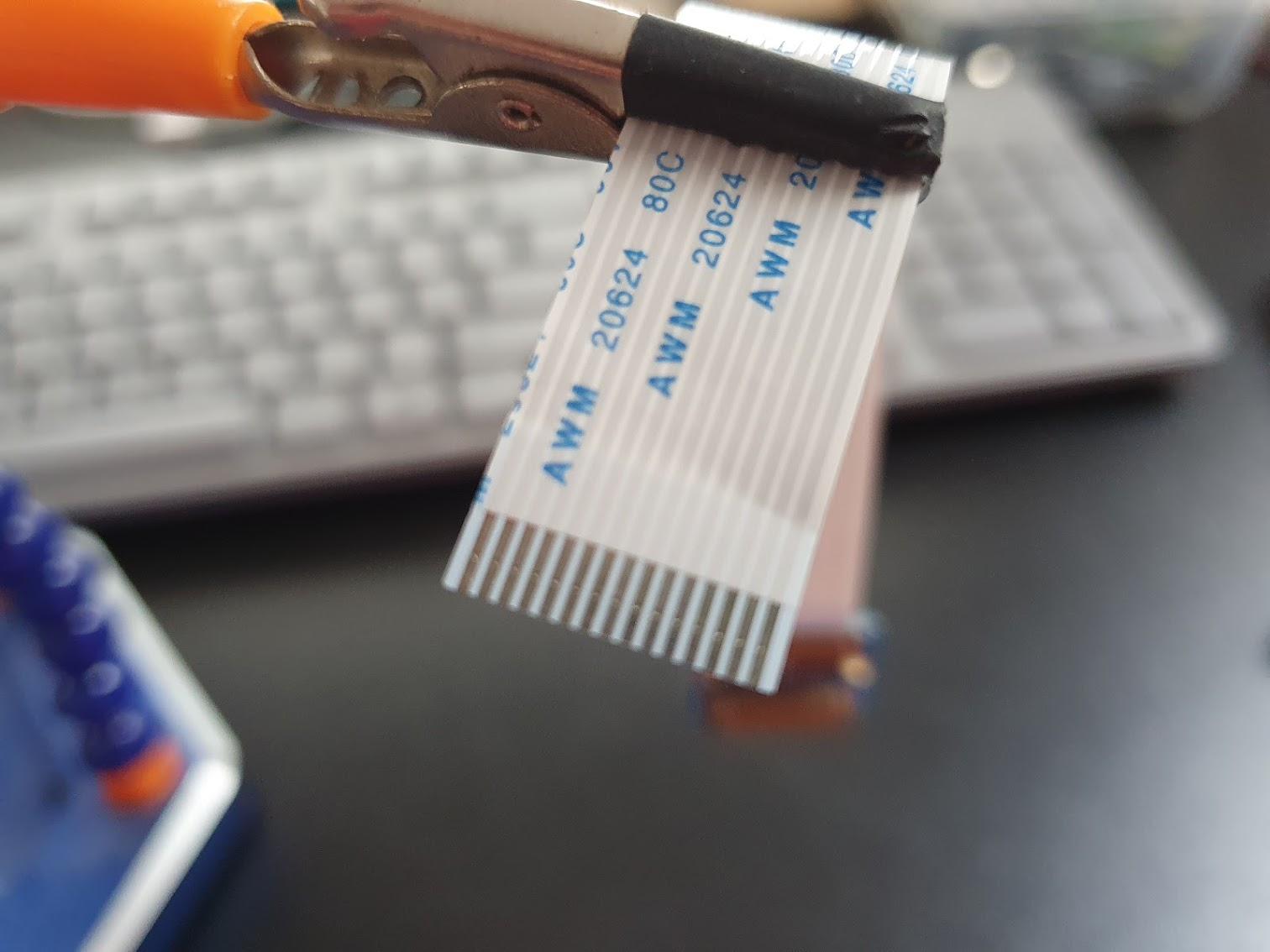

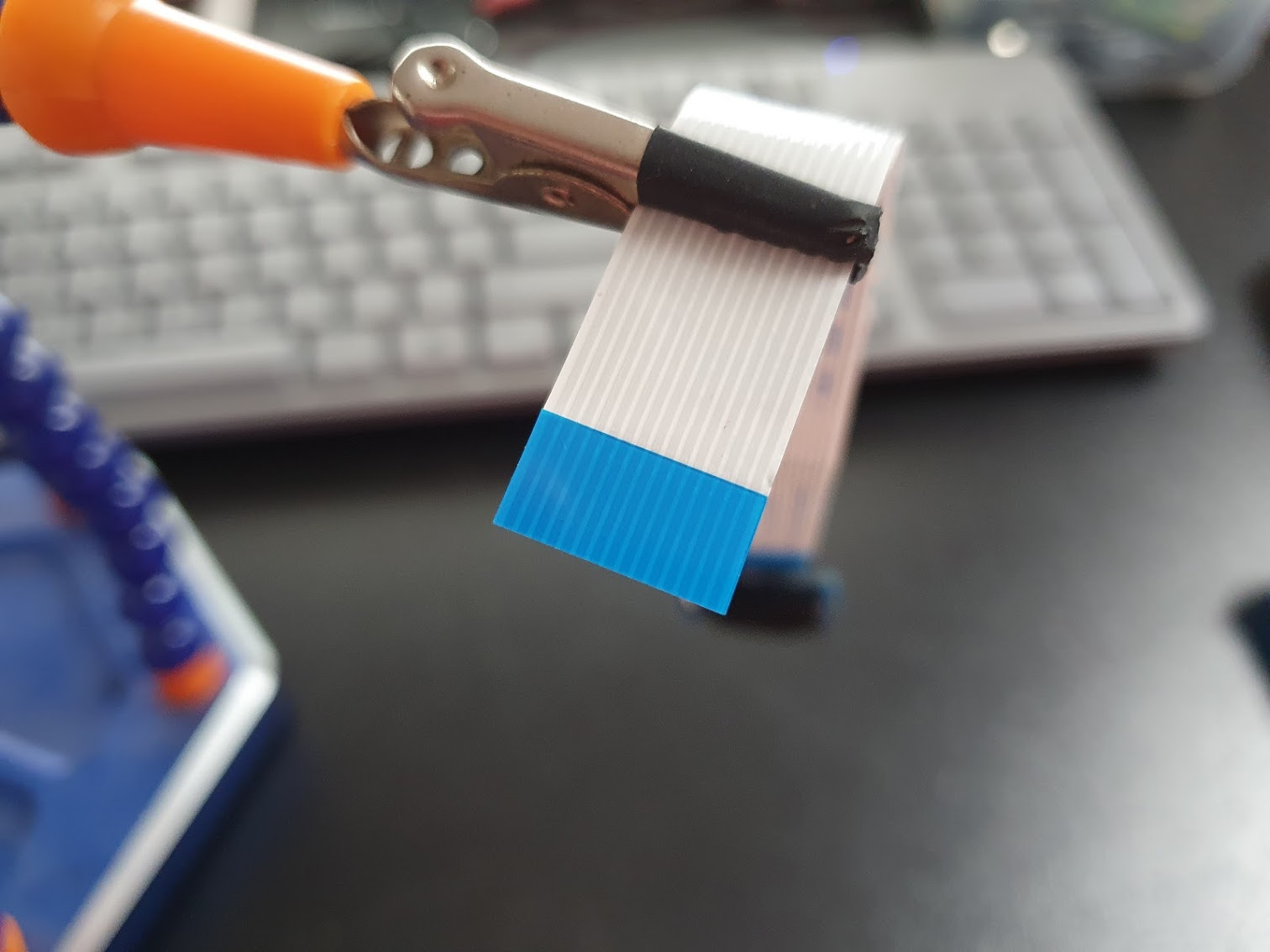

So now that we know where the pins are on the boards, let's inspect the CSI cable itself.
The 'pins' are exposed on one side of the CSI cable
And the opposite side is clearly labelled (blue here, can be different on other cables)

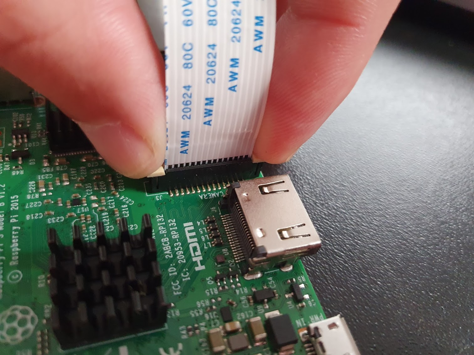

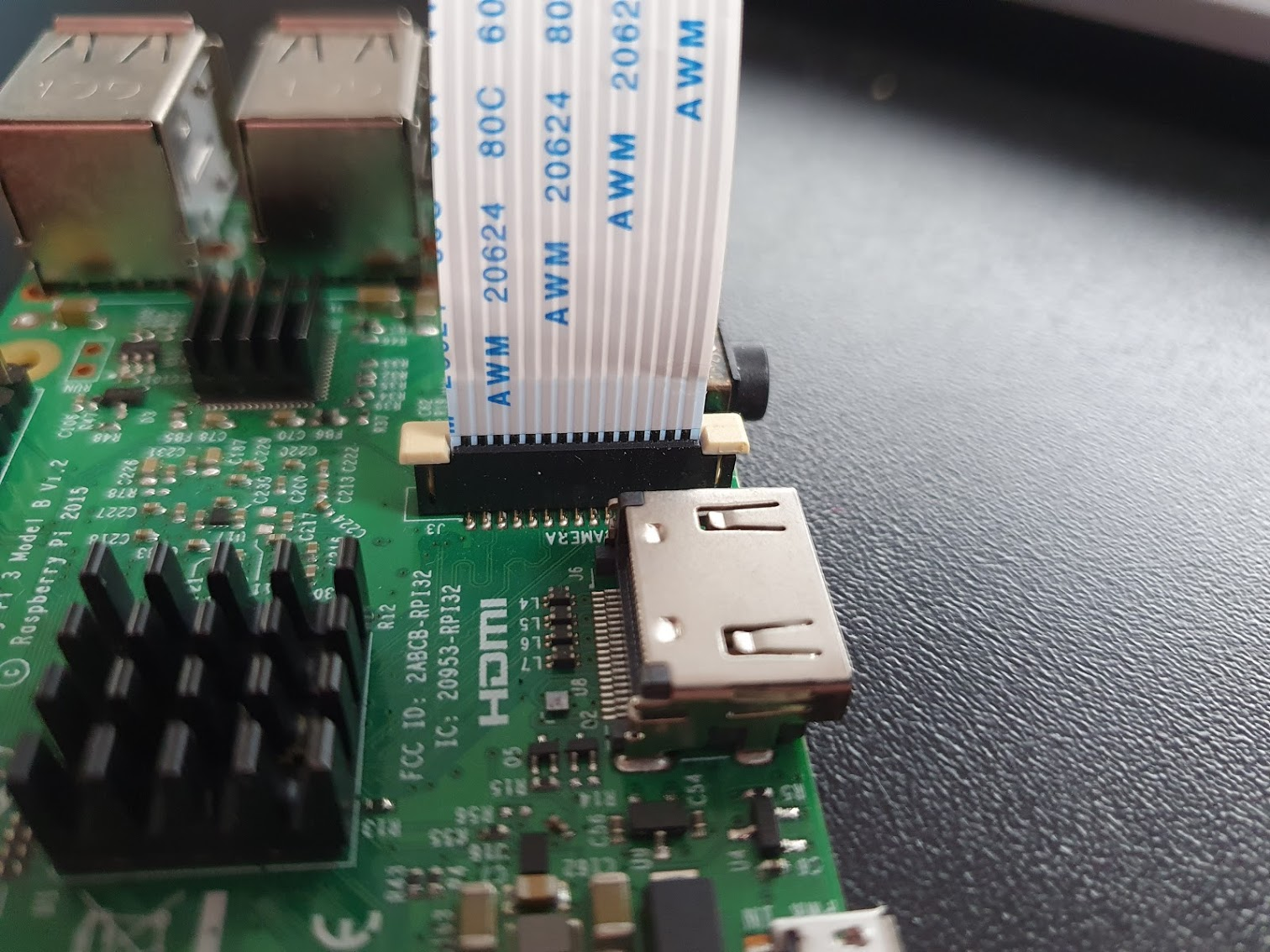

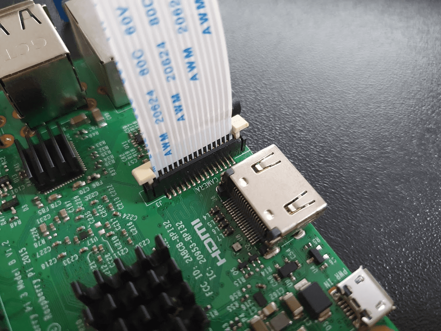

So now it's a matter of inserting the cable into the ports with the pins of the cable facing the pins of the connector, pull up the locking tab and insert the cable:
Pull up the locking tab and insert the cable with the pins facing the connector pins
Now using equal pressure on both sides gently push the locking tab all the way down while making sure the cable does not slide out:
Use equal pressure to lock the tab
Make sure the cable is properly seated before continuing.
A properly seated CSI cable
